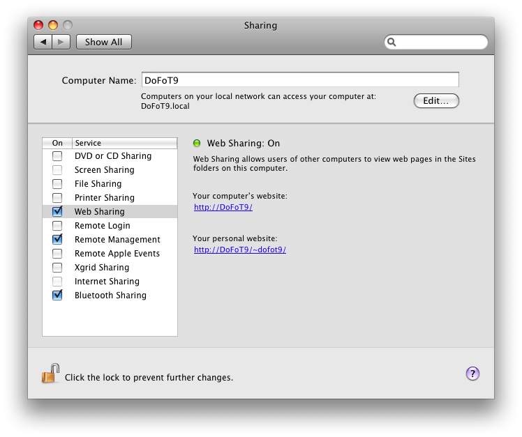

i turned on "web sharing" in system prefs, but nothing happens!!!
when i go to the two links provided by the system preferences- web sharing thing, it just directs to a site that cannot be loaded.

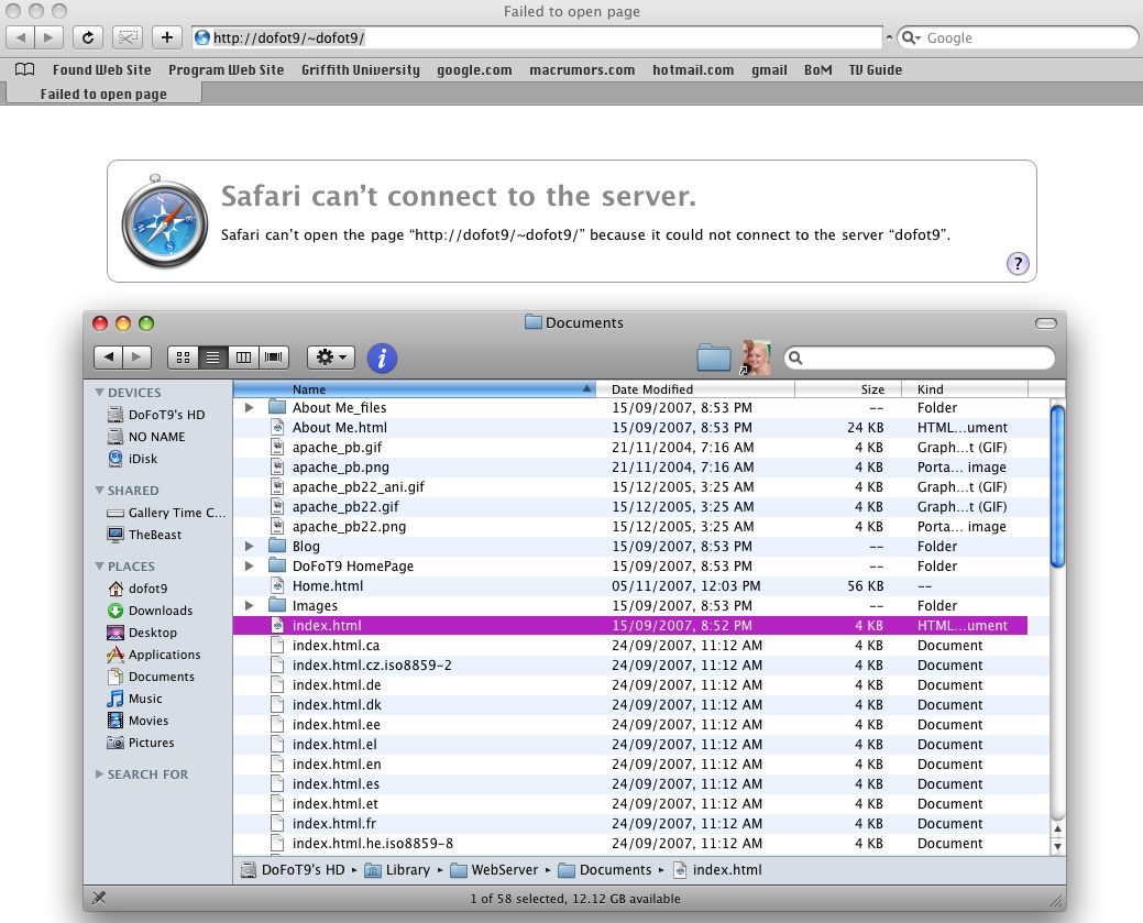

ok so it redirects me to absolutely nothing!!!!
the picture with the address (which i go to via the sharing system prefs pane) done absolutely nothing...
i have tried putting in my IP (which used to work) but now that is hopeless aswell.
i have also provided the directory for my website, which is in library>webserver>documents>index.html that is where it used to default to.
