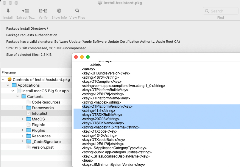

That is not true, check DTPlatformVersion and DTSDKBuild in Install macOS Big Sur.app/Contents/info.plist
If you have 11.6 Install macOS Big Sur.app in your Applications folder, delete it before you run InstallAssistant.pkg
It will probably not overwrite a newer version.

The link provided is certainty Big Sur 11.5 Disconnect from the Internet when you install it to avoid auto-updating during the install.
