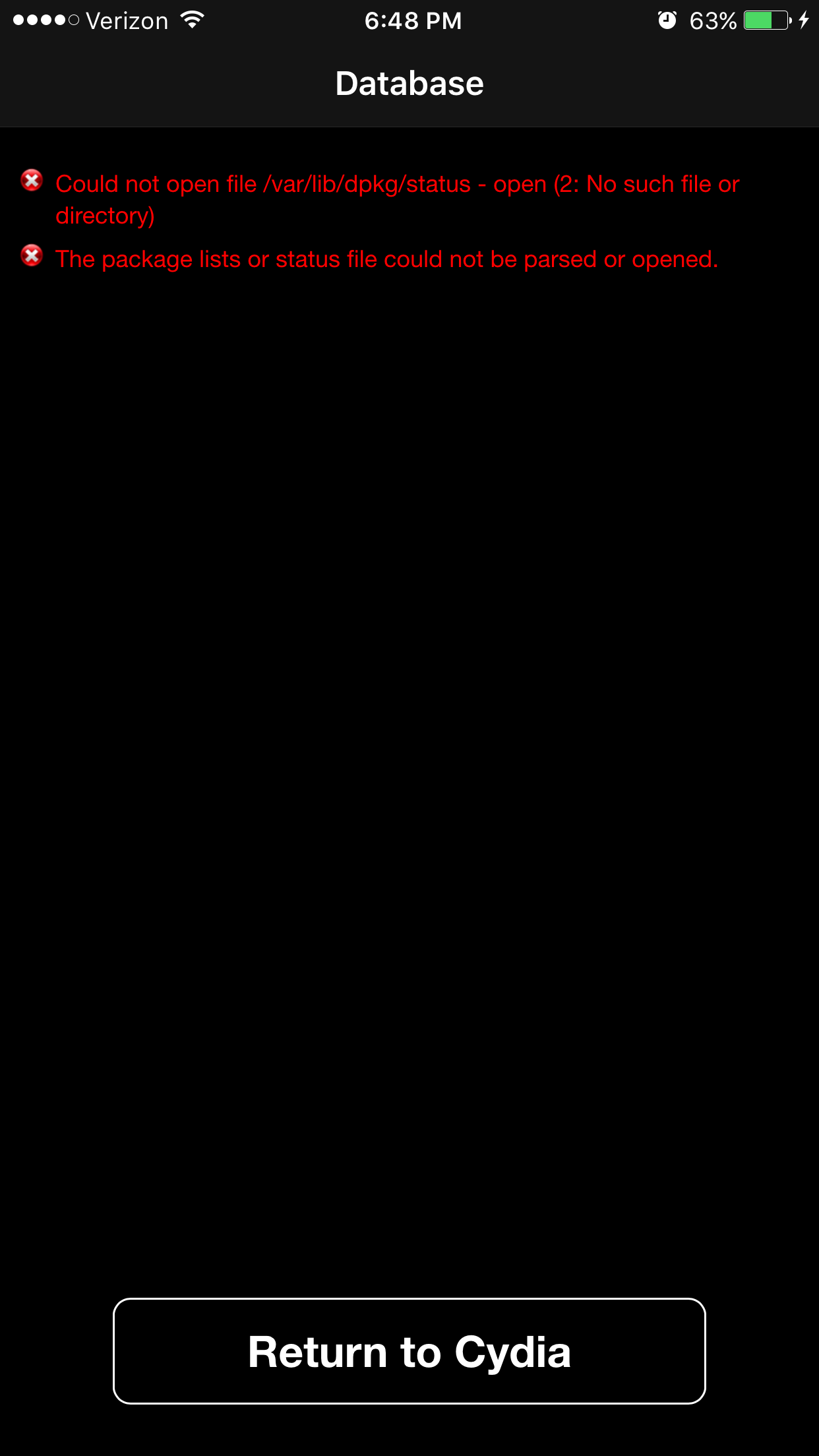

i deleted pangu from iPhone. Then restored iPhone and cydia app still exist. So I reinstalled pangu. Now I can't use or see the packages. How can I fix cydia? Or how can I get rid of cydia?

just tried that. Nope cydia is still there
[doublepost=1470018779][/doublepost]Any thing I can do to fix cydia? The errors in the picture? Seems like whatever I do cydia is staying with my iPhone. Factory restore, iTunes restore, dfu mode restore all
Have failed to rid cydia.

saying it's not possible is not any help lol. Yeah I erase all content and settings. And then restore as new phone on iTunes. Cydia is still there. I have jail broken my previous iPhones. And all it took was to restore to factory and back up from iTunes. All would be good. But not this time. I guess cydia came factory with this iPhone. Well if I can't get rid of cydia, can anyone help me fix cydia? It gives me that cannot load, and packages can't laod error message. I can't get rid of it and cannot use it wtf? It's irritating

Just made this account because the same thing is happening with me. Tried restoring multiple times with a backup and also tried restoring to factory settings. Each time Cydia and all the other tweaks have stayed on the phone. And even when I redone loaded pangu Cydia still doesn't work. Need help

Do not press the "upgrade" option in iTunes, you have to press the "restore" option in iTunes. Do not restore from back up, you have to start as new.
That will make sure you will not have cydia on your phone after the restore.

I had the same thing happened on my iPad Pro. Cydia would come back because I was restoring my backup from when I was jailbroken. You have to restore as new and not use an old backup.

I dont get why people dont just listen.. Dont restore from a backup that was made while jailbroken. If you do, this will be a repeat cycle. You have to restore from a backup made previous to the jailbreak or set up as a new iphone... PROBLEM SOLVED just in case anyone else is looking for an answer when they stumble across google results to here.
