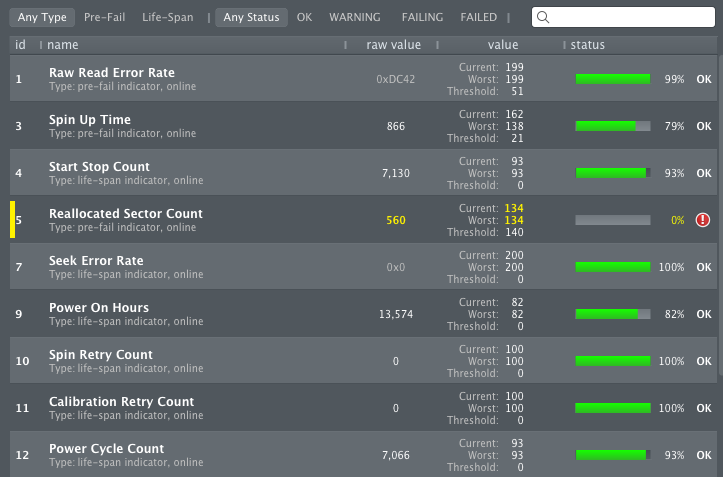

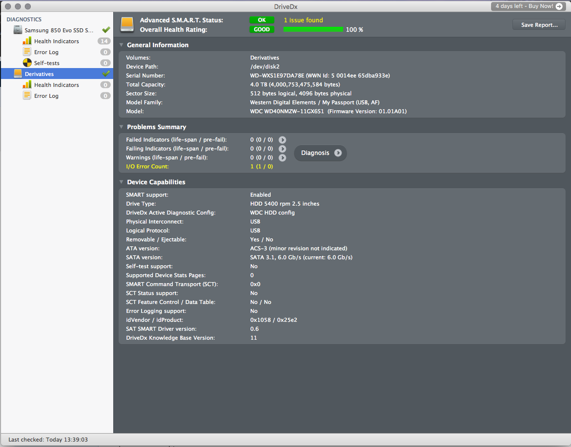

OP, to show what this can do, here are a few screenshots of specific SMART metrics pulled from a 2.5-inch HDD. This drive is straight-up toast. It has been marked as failed by Drive DX, and it is malfunctioning in actual practice. Seeing the surge in reallocated sector count leaves absolutely zero question as to the nature of this failure, which is hardware failure and the physical HDD itself is where the failure is happening (as opposed to a connection issue, data corruption, a power delivery issue, or failure of the enclosure/bridge.)
SMART is not perfect, but what we might be able to do with it is to determine if this is potentially an issue with the enclosure. Further, if the drive is failing, we might also be able to get a better idea of how severe the failure.
One limit is not all enclosures fully support SMART, and many G-Drive enclosures do not. The only WD enclosures I have are FW800, which do support SMART to allow all individual metrics to be pulled, but I cannot speak to your enclosure (so you need to try this first.) If you cannot pull SMART data from the current enclosure, moving the drive to a different enclosure may be advisable.
In sum, this will hopefully provide a clearer picture of the problem.

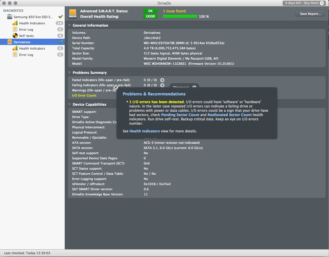

Well, have tried plugging in my bad drive, and the light is just blinking on it, diskX does not see it because it is not mounting in macos.

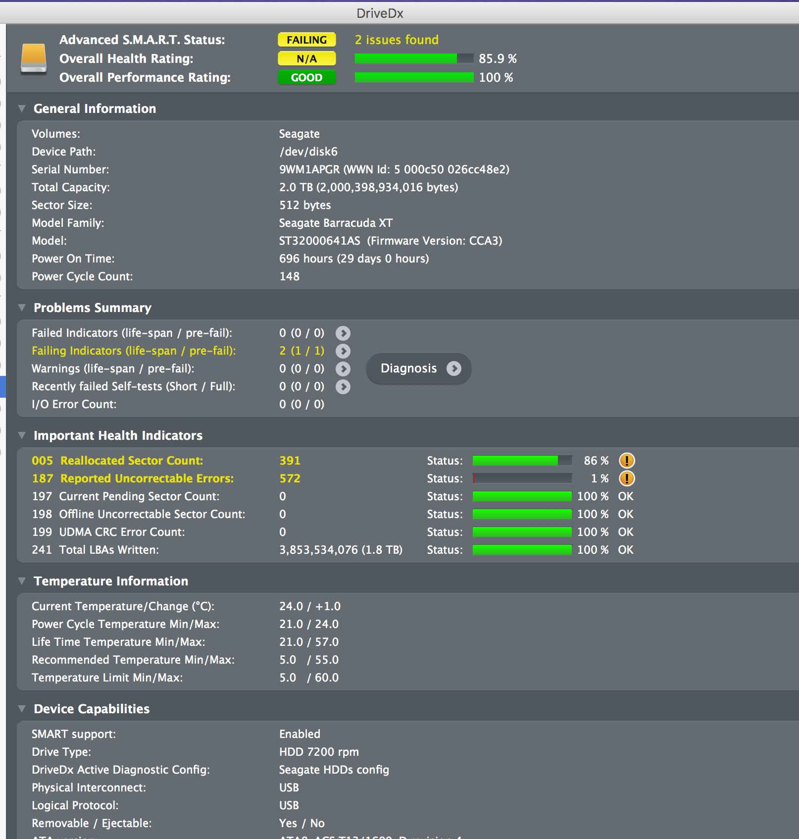

Ok, the bad drive finally mounted, and I ran DiskdriveX and here are the results;
I noticed also, when my mac went to sleep, I touched a key to wake it, and the mac fans started up, but the screen hesitated to light back up, I had to wait a minute first, then it came up, maybe from the hard drive hanging the system.
Edit; now the disk is ejecting ,and os is saying it is not ejecting properly, and dowes not show up in dskdrive or macos.
What? Have you not got any Uncorrectable Errors? Is that it? I/O error? What does it show for Pending Seector Count and Reallocated Sector Count? Have you tried changing the USB cable and/or the power supply if it is a drive with a PSU that goes into the wall outlet?
