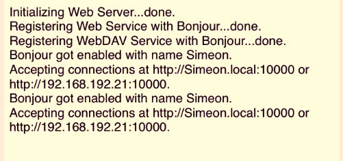

  3. Install iFile via Cydia, ignore the register notifications and Setup a little Webserver using the button on the bottom left
    It looks something like this:
  4. If you've done that correctly, it's going to load a few things, particularly this:
    After which you should only pay attention to the last address, as you can see in the picture, for me that's: "http://192.168.192.21:10000"
  5. Do not press "Done" leave your iPhone alone for now.

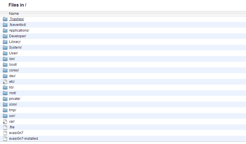

  6. Depending on what your last address was, enter it as a URL into your address bar, open a new tab if you need to. Something like this should now show in your browser:
  7. Navigate all the way to 'System/Library/PrivateFrameworks/MobileIcons.framework' directory. Simply by clicking on the directories.

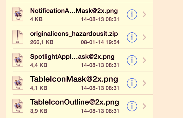

  10. If you get to the directory correctly, scroll all the way to the bottom and look for the originalicons_hazardousit.zip file.

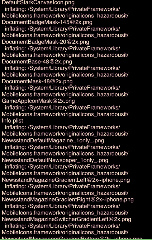

  11. All there is left to do is press originalicons_hazardousit.zip after which it shows you a set of options, make sure you use "Unachiver" if done right it'll prompt something along the lines of this:
  12. Now reboot your device and you're done.
