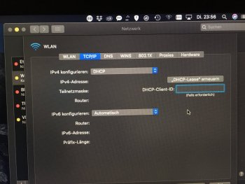

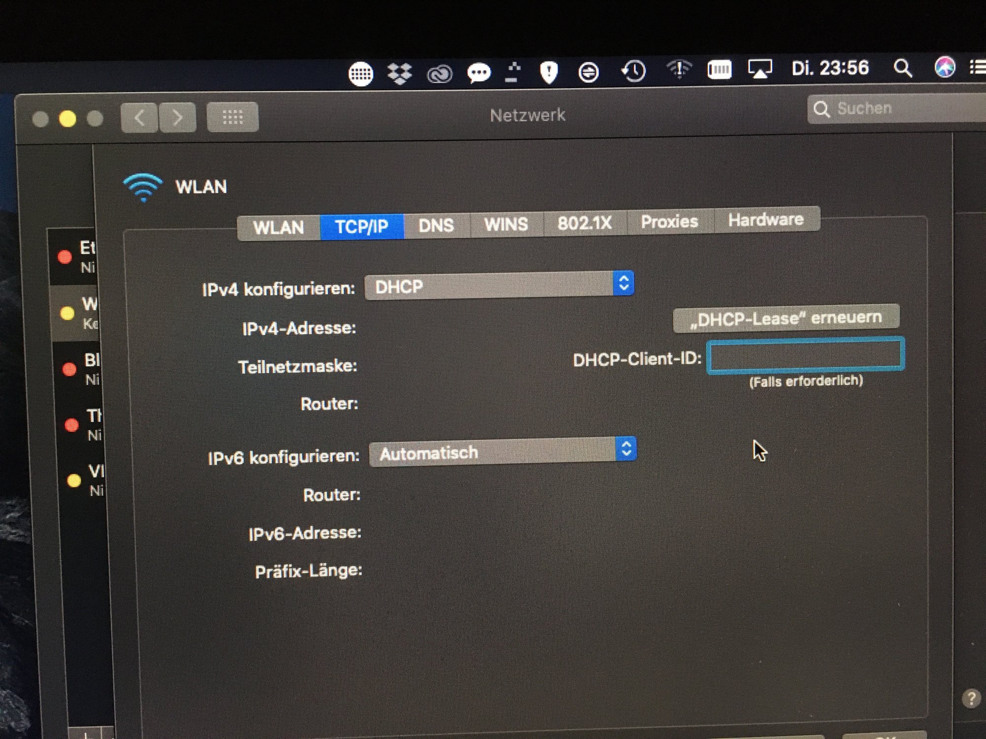

Could you put a screenshot of the section where you say your iMac has nothing filled in? It’s OK to keep it in German 🙂
Is the drop down set to DHCP?
Hey, thank you for your reply.
Yes it is set to DHCP. I tried to work around with the manual stuff but it did not work out.
DHCP seemed to have worked before and on my MacBook its still working.

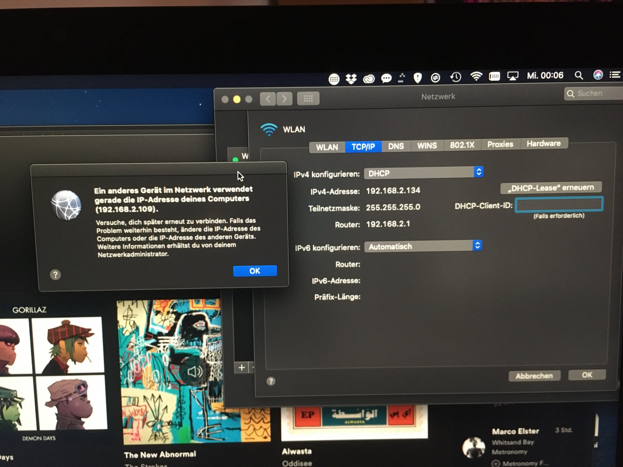

Attached is the screenshot you asked for. There is just nothing showing up even if i keep it open for a while.
This seems to be worse on the TimeCapsule as i seem to sometimes be able to get a connection with the Telekom router for a short while in MacOS. In Windows it worked as well on the Telekom Router, no idea how long, just did a quick test.

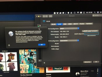

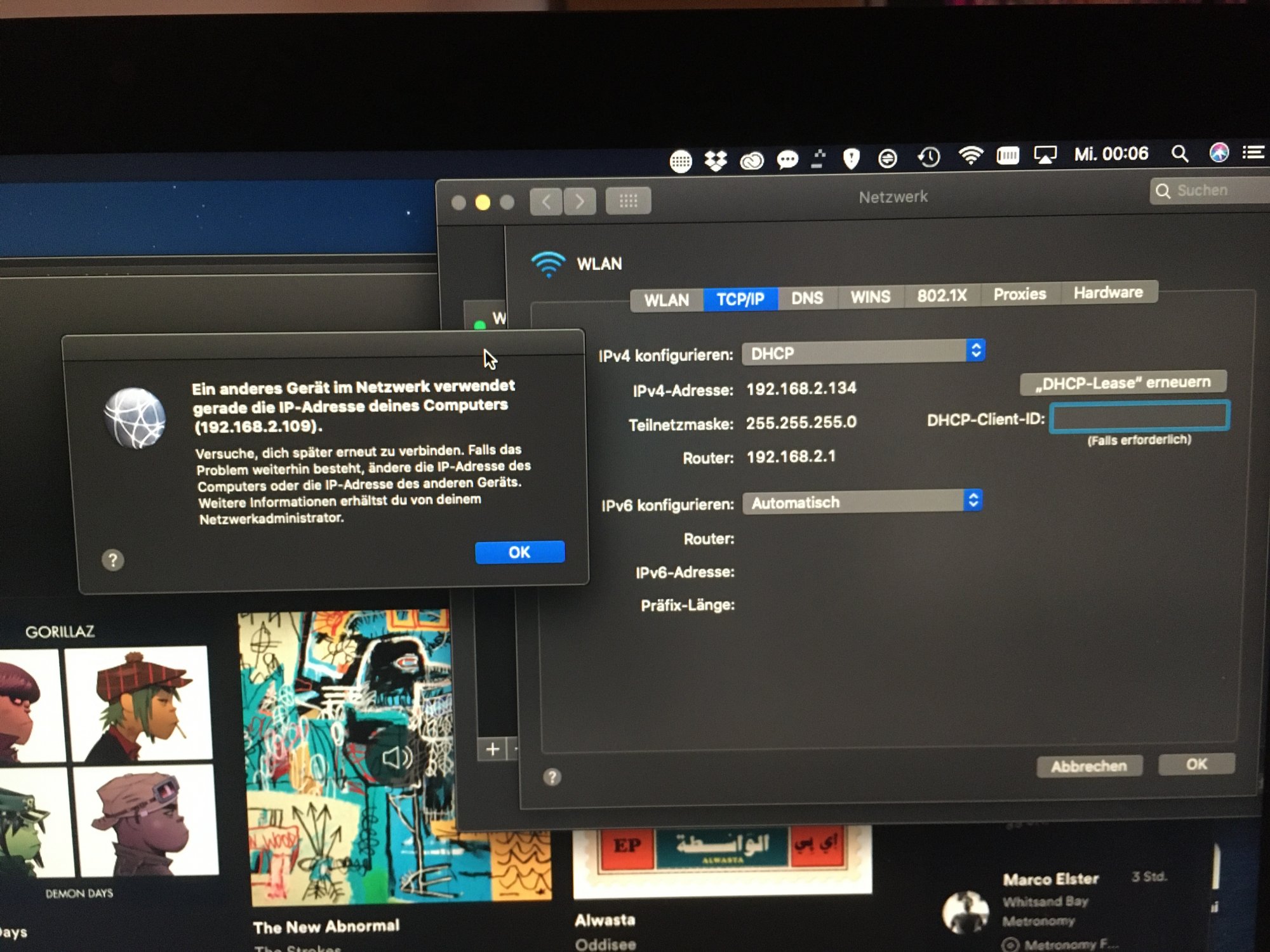

Second picture is using the telekom router. Numbers show up, than it says IP is in use, but aperently mostly is working for webpages while spotify dos not play music
