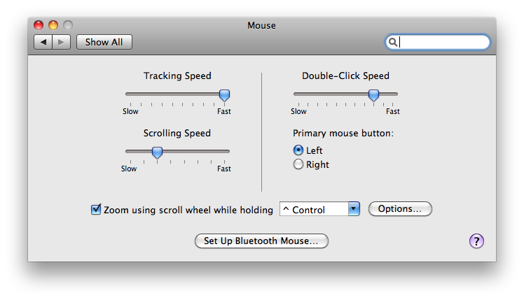

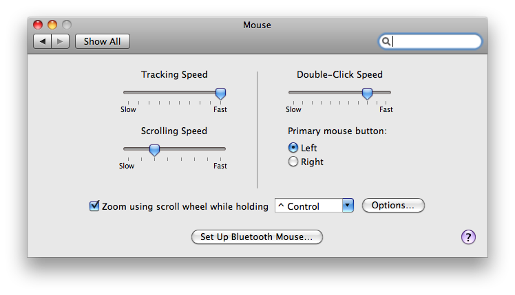

Apparently someone changed the setting in OS X for Primary Mouse button.
Tried that
I tried both mouse buttons on all three mice but it never left clicked. Also, that would be impossible since i was on it at the time it happened. Like I said, I just went to click Safari in the dock and it didnt work. System Preferences wasn't open either. I did think about that though, however, i wasn't able to get to the mouse prefs through spotlight (cmd+space then typed mouse since i cant click).
