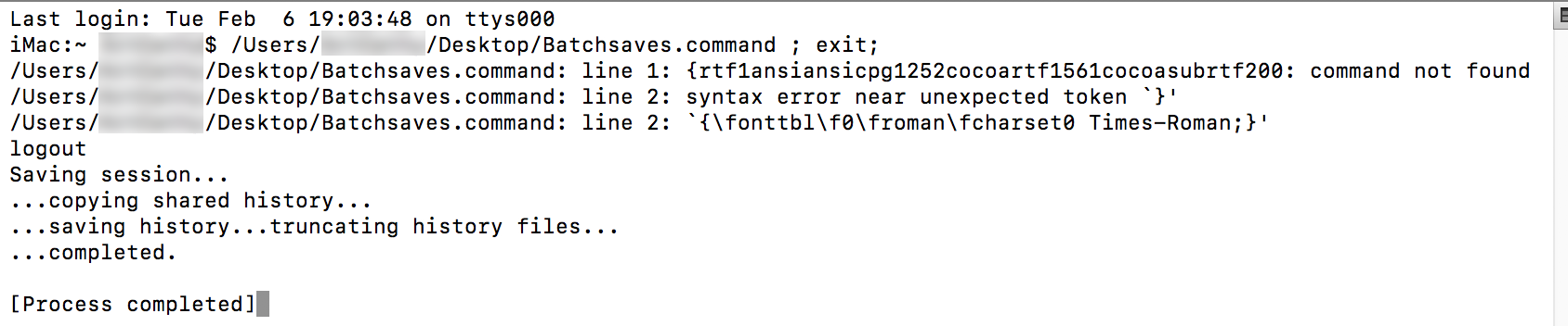

I've run into a snag on this. I think I created the .command file correctly (I called it "Batchsaves"). It's trying to execute the commands. I tried copying items as text only, but that didn't fix the errors. I also tried re-entering the text manually. How do I correct the errors in the attached? :confused: Thanks. command error.png
Can you post the complete contents of your .command file or a screenshot of it?
Did it copy anything?

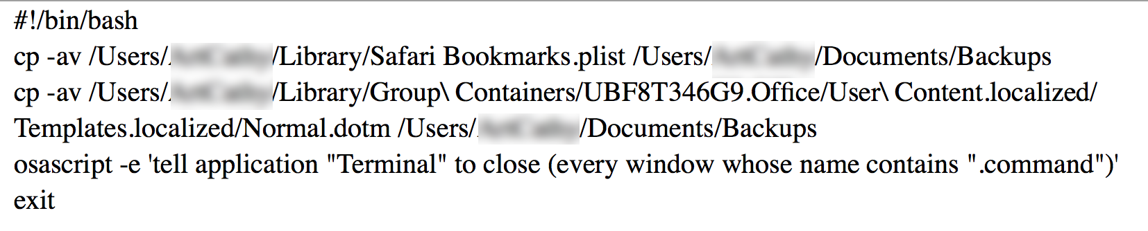

neliason: Here's a screenshot. It didn't copy anything. Thanks
Is the 3rd line ‘Templates’ just wrapped and really part of the 2nd line?
It looks like you are missing the ampersand ‘&’ at the end of the osascript line. I believe this is necessary to get that to work properly. There should be a space and then the ampersand.
I’d fix the missing ampersand. If that doesn’t work then I’d start commenting out all the lines but the first ‘cp’. You comment with a pound symbol ‘#’ at the beginning of the line. If the first command works and copies data then uncomment the next line. Keep doing that until you find a line that causes an error.
Thanks, neliason--yup, I missed the ampersand at the end of the osascript.
I get errors in the two save commands no matter what. But when I enter them individually in Terminal, they work. What gives with that? I think it's odd that capturing the path to these files produces such a strange-looking path with unexpected spaces and slashes. Still, by themselves, they work in Terminal but not in the .command file.
The slash escapes the space in a file or directory name. If the commands work when directly entered in a Terminal they should work in a script. The error message should point you to the problem. I’d comment out everything but the cp lines and see what the error is.
