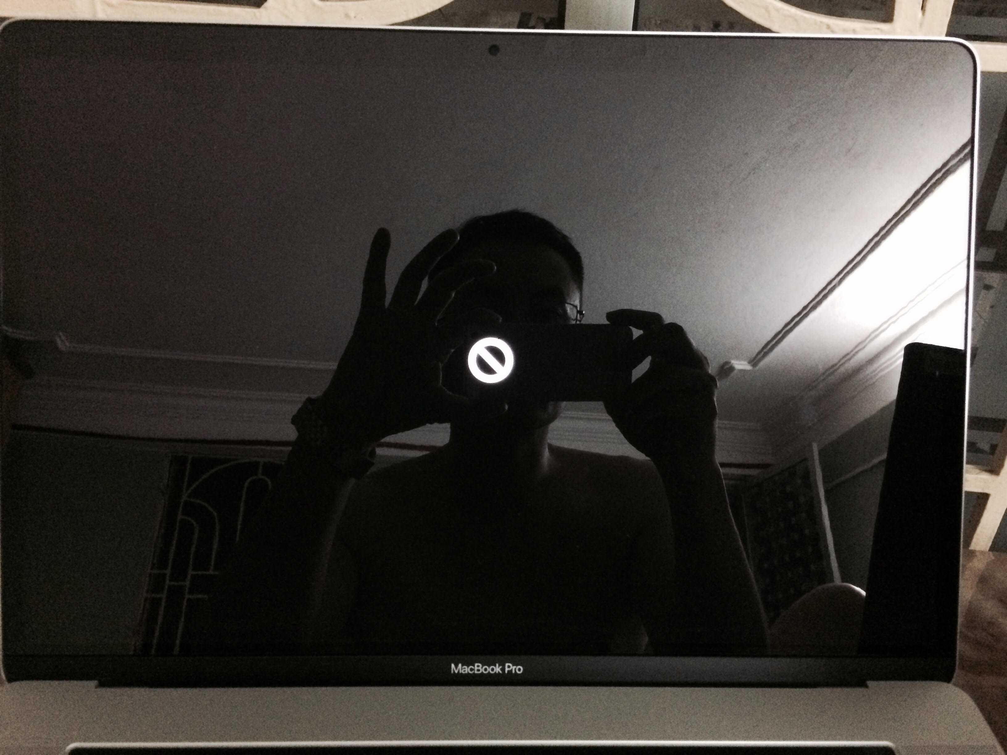

I reinstall mac os high sierra. I download mac os high sierra 10.13.1 from torrent, restore to usb 16gb with transmac. Then boot into USB. I only saw the icon "install Mac os", then I clicked it, it appears on the image as in the attachment and stop there forever. I do not know what the problem is. Please help me what and how to do next?
thank you very much.
"I download mac os high sierra 10.13.1 from torrent, restore to usb 16gb with transmac."
If you're trying to create a bootable USB installer on a PC (even with transmac) -- I don't believe you can do this.
I could be wrong, but I believe this MUST be done "on a Mac".
On the Mac, you need ONE of the following:
- Boot Buddy
- DiskMaker X
- Install Disk Creator
Also, are you sure you're getting a good copy of the installer "over a torrent"?

Same here. But, I make the bootable pendrive with Diskmaker and voila! everything goes well.

Just use internet recovery. That way there's no need to use a questionable installer downloaded from a torrent.

If the computer has had High Sierra installed on it, which I assume is the case because the OP mentioned reinstalling, then yes, the computer will get High Sierra installed. This changed starting with 10.12.4. https://support.apple.com/HT204904
Starting with Command-option-R will reinstall the latest operating system from internet recovery. Command-shift-option-R will get the operating system that came with the computer.
Apple's instructions to create a bootable USB installer have been 100% reliable for me. https://support.apple.com/HT201372
