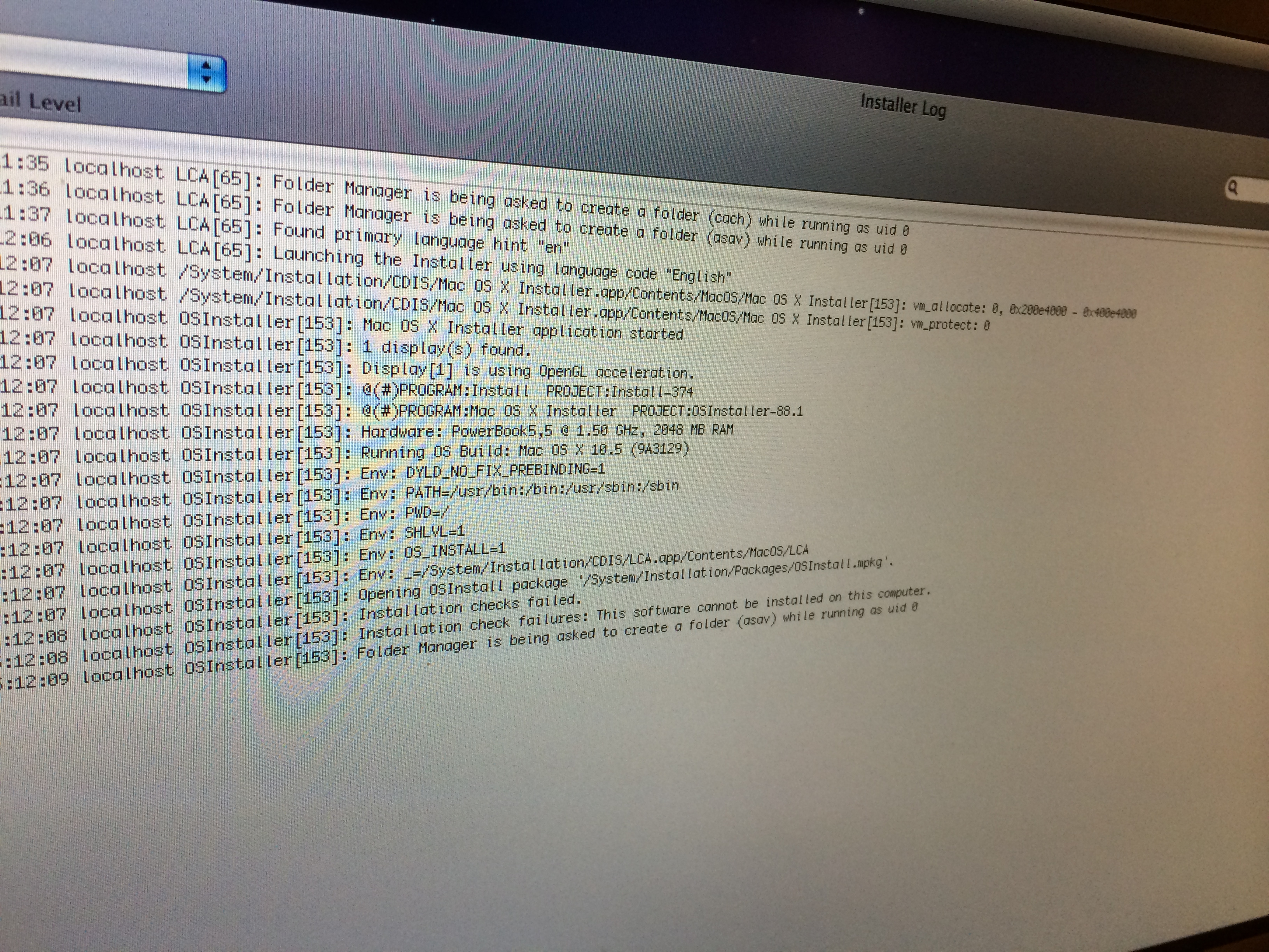

Are you getting a more specific error message? If not, check the install log ( :apple:+L ) to see what's going on - make sure to change to "All Logs" view. Report back what you find.
I attached a picture of all the logs that I saw.

Right, thanks. How unhelpful. It doesn't tell me much. 🙁
The next thing to check is the disc you're using. Back when OS X discs were still a thing, there were 3 kinds in existence: Machine-specific (gray), retail (black and purple mostly), and drop-in upgrade only (don't know what color these are - I never got the chance to see one). Of the three kinds, upgrade-only discs will ALWAYS produce this error if you erase the drive; machine-specific discs will produce this error if used on the wrong Mac type / model / year, and retail discs should never produce it given the conditions you're installing under.

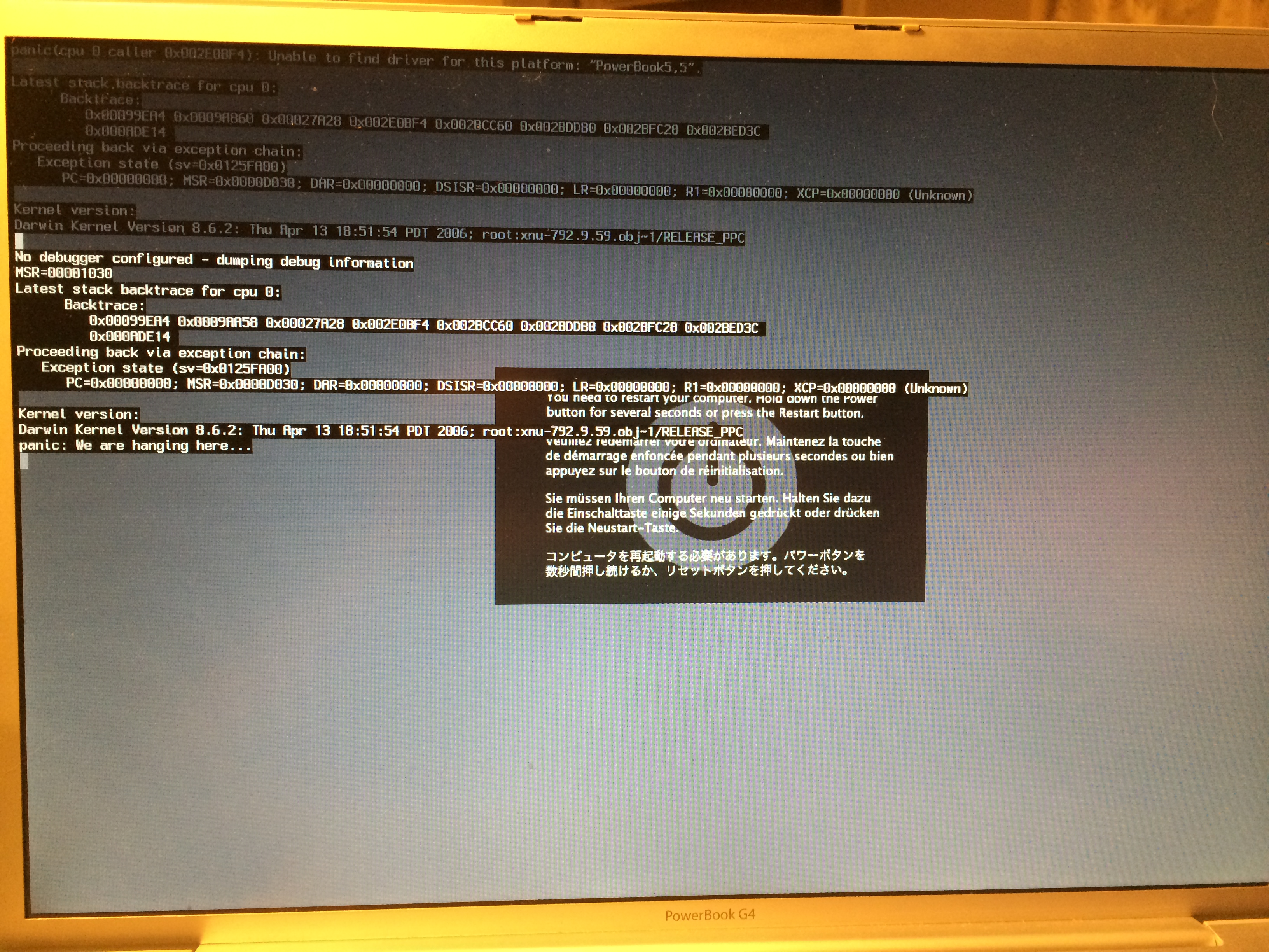

I found another disk that was also Grey, but had the words 17-inch macbook pro. I know that this is a powerbook, but I thought I'd give it a try and see what happens. If it didn't work, then I could eliminate the possibility of using it. This is what happened, this never did this with the first grey disk. I also did try to restart like it says, and it gave a beep when it was turning on and gave this screen a second time.
The MacBook Pro disk definitely won't work as its for an Intel Mac.

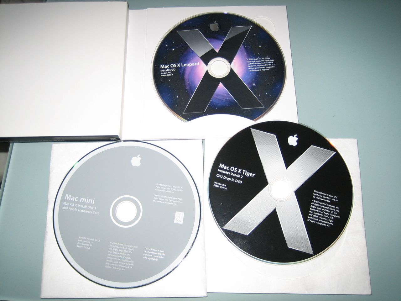

You need either:-
A) The specific grey install disk that came with the Mac, ones from other Macs will not work.
For example the one in the bottom left of my photo only works with a Mac mini G4.
B) A retail OS X disk. In my photo thats the one at the top of the image which is a retail 10.5 Leopard disk.
They look the same as the retail disks as far as I know, they just have CPU Drop in DVD written on them instead of Install DVD.
The disk in the bottom right of my photo is the drop-in DVD for Tiger that came with my Mac mini G4.
