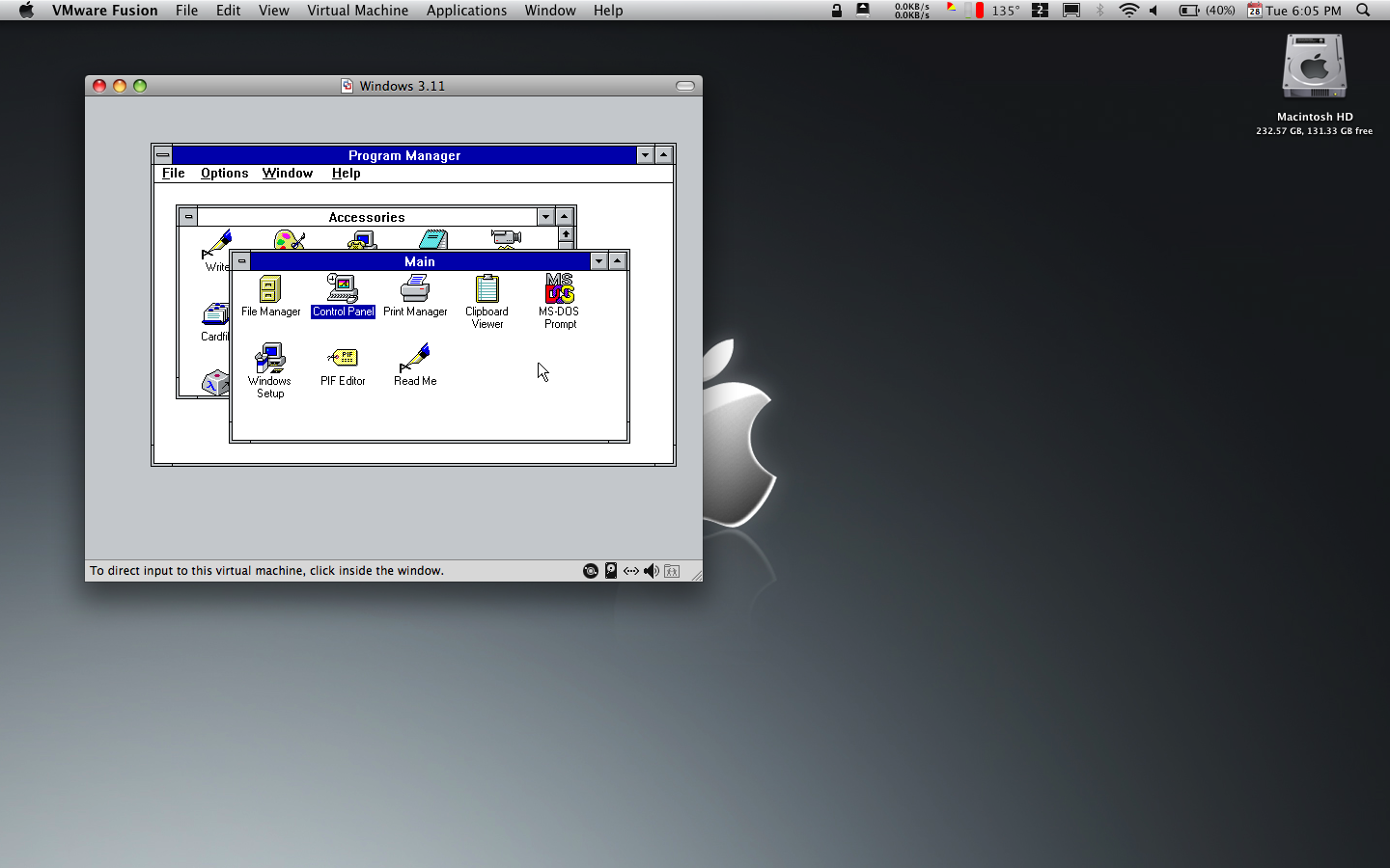

I didn't actually think it'd be possible myself, but Windows 3.1 is actually in the list of OS's that Fusion supports. I found this copy online so I was actually able to get it running on Fusion 2 in Leopard 10.5.7, but I'm still trying to get my own virtual machine running from scratch.

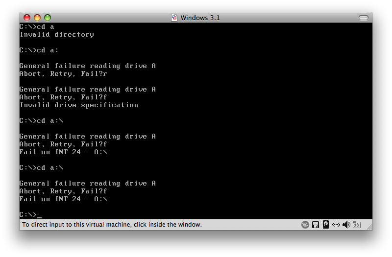

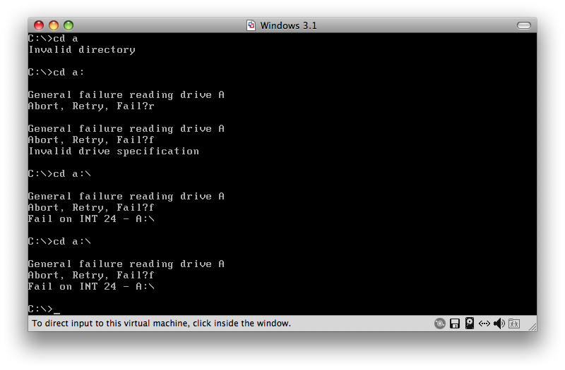

Back to the original topic, I got my computer back and finally got around to setting up (or at least trying to) my own Windows 3.1 machine. MS-DOS 6.22 installs and runs perfectly fine, but this is what happens when I try to run the Win3.1 installation:
My only thought at this point is that the disk image isn't bootable or whatever. Last time I tried I was pretty sure, but I just looked at it again and it's actually a 10.6 MB file so more than likely that's my problem 😛. Unless anyone else has any other ideas?

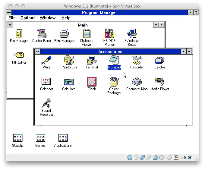

Well this post of yours has caused me to spend a great deal of time setting up Win 3.1 first in DosBox, and now in VirtualBox. But I have to admit, its been fun. 🙂
I have the setup floppies for DOS 5.0 and Win 3.1. Plus a upgrade to Win 3.11, and Internet Explorer 3.0 with stacks and dialers on floppy disk as well. I ran into a road block trying to install DOS 5.0 in VirtualBox on my macbook. Tried making disk images of the setup floppies, and just about everything else, only to find out that DOS 5.0 will only install from a actual floppy drive. I didn't remember that, but it is a fact.
This presented a problem considering macbooks do not have floppy drives. So I had to go back to my nine year old pc (never get rid of old equipment) which dual boots xp and PCLinuxOS, and has a floppy drive.
In PCLinuxOS I installed the latest version of VirtualBox, and from there created a DOS 5.0 virtual machine. Copied the DOS vdi and the Win 3.1 setup files to a flash drive, and copied it all to my macbook.
After setting up a virtual machine with the DOS vdi, I next needed to transfer the Win 3.1 setup files to the DOS virtual disk. Now, I could have just installed Win 3.1 from the floppies while on the pc, but I wanted to do as much as posible from my macbook. Don't ask me why, I have no idea. 🙄
So, I attached the DOS vdi as a secondary hard drive in my XP virtual machine, booted XP, transfered the Win 3.1 setup files from VirtualBox shared folders to the secondary hard drive which is the DOS vdi. From there I shut down virtual XP, booted DOS 5.0, CD to the directory that contained the Win 3.1 setup files and ran setup.exe. The funny part of it all was that it took Win 3.1 about 30 seconds to install. 😎
I'm thinking about installing the 3.11 upgrade, Internet Explorer, and surfing the net from virtual windows 3.11. That would be something I have never done before. 🙂
Hope you get 3.1 going soon. The pic in your attachment is caused because DOS can't read A:\. Try putting the setup files in a directory on your virtual DOS drive and run setup from there.

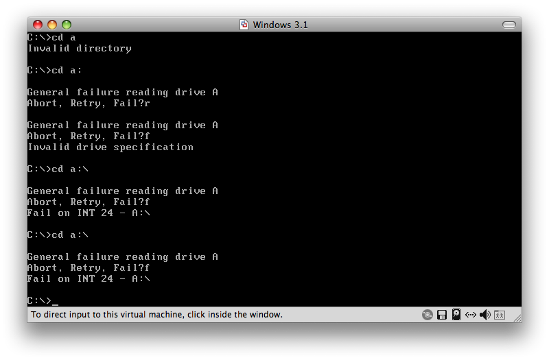

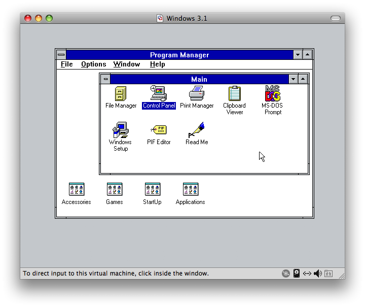

My most heartfelt thanks for your last post, Steve-M! I was able to setup my DOS6.22 image file as the 2nd drive in another XP machine and copy all my Win3.1 setup files over. Setup completed so fast, and that was even going through it manually to customize some things! WOOHOO!!!
My only problem was that I wasn't able to get networking working right during setup, so I'll have to go back and mess around with that. But at least the OS is up and running! Thanks again! 😀
