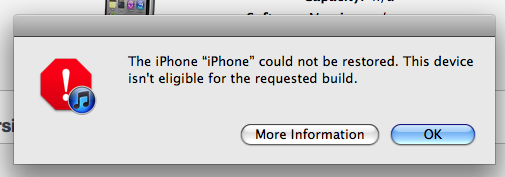

Help! I have been trying this for almost 12 hours now and I am desperate!
I first tried jalbreaking my iphone with pwnage, then with redsnow, both softwares got to the point where I would have to restore my iphone with their customized .ipsw, but everytime it tries to finish, itunes pops up a warning (picture attached.
I am so desperate! What can I do?
(I am running the 4.3.3 software, no clue about the band, because I cant even turn my phone on, also, my phone is not active with any carrier right now. I was with ATT, switched to a different phone/carrier, now trying to unlock/jailbreak my iphone for Tmobile)

Can you put the phone into DFU mode, then click Shift+Restore in iTunes (it should pop up and say "iTunes has detected a device in recovery mode"). After that select your 4.3.3 firmware and install (I would recommend downloading it from iClarified (if using Windows, make sure you click "save target as", then choose "all files" from the drop down at the bottom of the window, add ".ipsw" to the file name when you save it - otherwise, windows likes to save it as a Zip file).
If you want to JB after that, go with the Jailbreakme.com version.
Sorry if you've already tried this (also, make sure it's DFU mode, and not just recovery with the iTunes USB connection logo on the iPhone screen).

thanks for the replies, i used whatever redsnow ipsw was (came as a bundle) and for pwnage they made a custom one, neither worked. I have a mac.
i can not use jailbreakme.com because i dont have service with the phone, therefore i cannot go online with it (and you need to access jalbreakme from your phone)
when i get to the restore part, i hold down option and click on the itunes restore button...it tries loading it but then that warning pops up that i had attached. the only thing i can do is upgrade to 4.3.5 and restore it, but then i cant jailbreak it anymore with redsnow or anything else (havent found anything yet). Any suggestions?
Unless the baseband was preserved from firmware 4.0/4.0.1 and is 1.59, you won't be able to unlock it with ultrasn0w anyway. You'll need a Gevey SIM, and most of their models don't require a jailbreak.
And do you have blobs for 4.3.3? If not, that's likely why you can't restore.
hahaha, sorry, I have no clue what you just said 🙂 could you explain a blob? i dont know my baseband
Irish Vixen is correct you need SHSH blobs to restore to anything other than 4.3.5.
Simple explanation: Apple prevents you from updating to any version of IOS except current version. They do this by signing only that version.
SHSH blobs is signing fake out so that you can install other version. You have to capture the SHSH blobs while it is still being signed for future use.
Hope this helps.
That's what I was afraid of.
You're the original owner of the phone?
If so, and you have no idea about blobs or preserved basebands, you can't unlock that phone through software. SHSH blobs are a security signature; they're unique to your device and must be saved while Apple is still signing a given firmware. Otherwise, you cannot downgrade or restore to anything other than what Apple is currently signing--which right now is 4.3.5.
As for baseband, if you didn't take active steps to preserve 1.59 from when the phone was on 4.01, your baseband isn't unlockable with software, period. Your only unlock option is a hardware one, and you'll need to purchase a Gevey SIM to use TMobile. You'll need to research that so you know what you're getting into. If you go that route, you will be unable to upgrade to iOS 5 as it is not compatible.
hmm...so youre saying i should either upgrade to 4.3.5 or get gevey sim? or just get gevey sim?
and yes, i am the original owner, no clue about blobs and basebands. 🙂 lucky me
Well, if you can't get the phone to even turn on, odds are you're not going to be able to get back to 4.3.3. If you had blobs, we could walk you through a restore, but without them, it's not going to work.
Once you're on 4.3.5, you can either stick with AT&T--which won't require anything--or get a Gevey SIM if you want to use TMobile.
