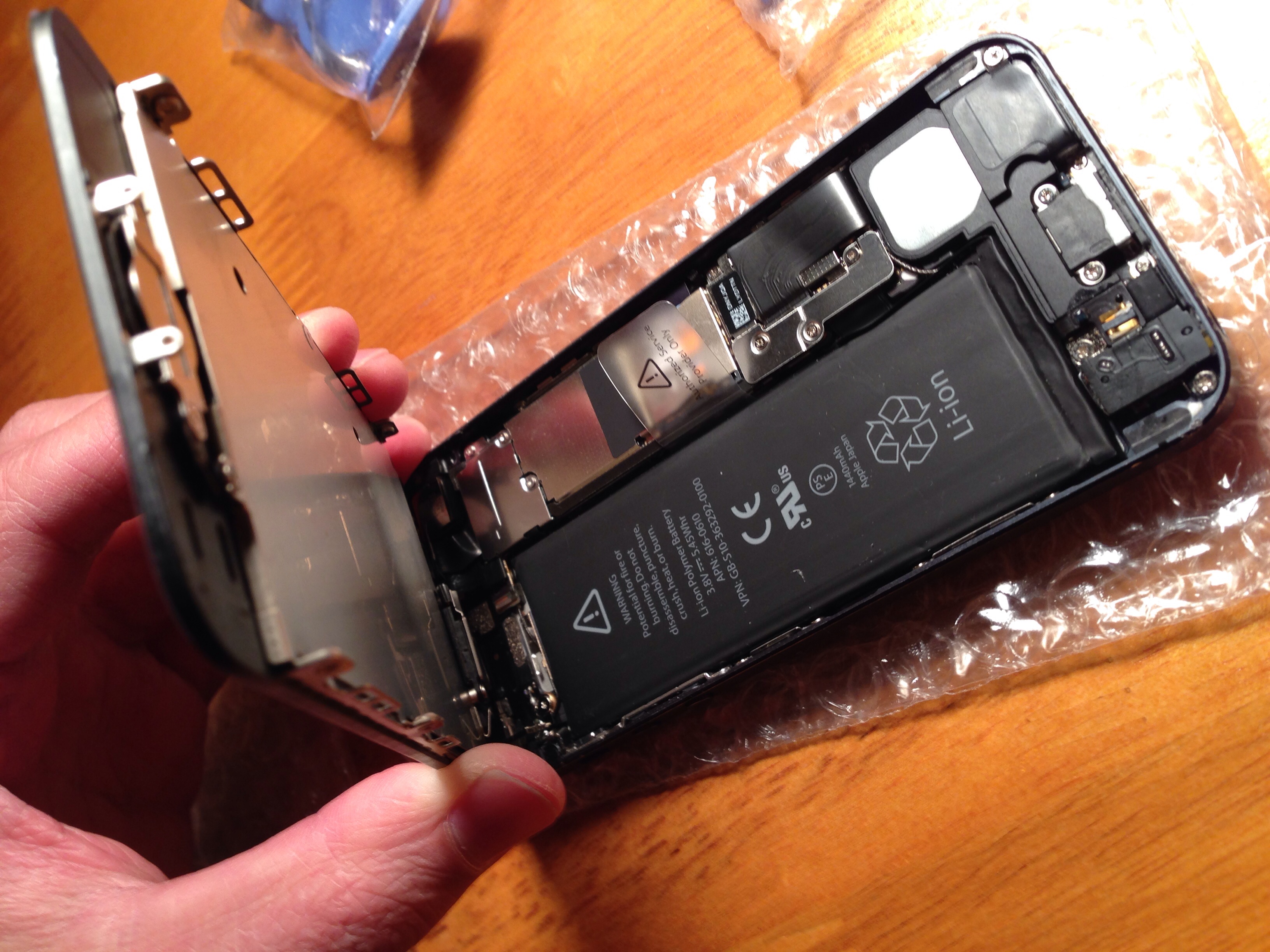

Do you have a "pentalobe" screw driver to remove the two screws securing the display assembly at the bottom? If not, I highly recommend obtaining one before you attempt this job. After you remove the screws, just be careful when removing the display; you'll want to lift carefully from the bottom end upwards because the display flex cables (one for digitizer, other for LCD) are at the top connected to the mobo. You'll need a number 0 Philips driver to remove the two cables because they are secured by a bracket enclosure. See my pic.
