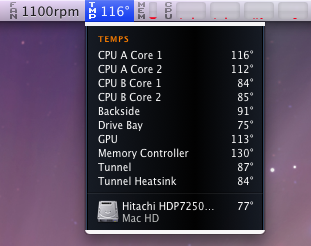

Okay, so here are the temperature stats with iStat Menus:
This is while the computer is fairly idle in terms of things running on it. As you can see, the CPUs don't show much activity. With this Safari page open, I am getting around 123F on CPU A, with CPU B at 117 (and the other two cores at 86F). Currently, as stated, the fans are blasting.
EDIT: Whilst loading more MacRumors pages, the two main CPUs went up to 150F, and now settling down again as I stay on this page and type these words.

I think it is worthwhile checking the info.plist on your AppleFan.kext in /System/Library/Extensions and check on the values on the fan speed table. Before doing this I would suggest a thermal calibration first.
