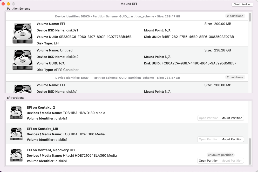

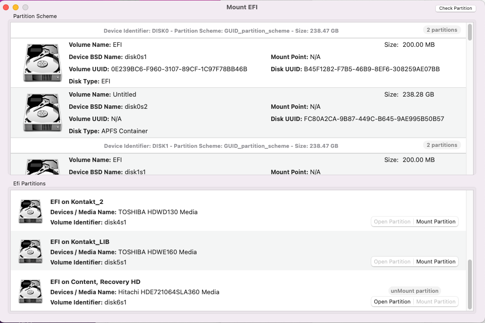

Nothing in top right hand corner but there's a 'Mount EFI' option in the tools menu. I've mounted the partition -now what?

But what do I do after I've mounted it? I'm at the screen grab attachment above. Do I open it now? TBH I have NO idea what this app does

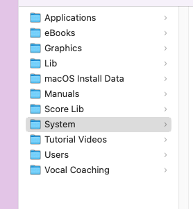

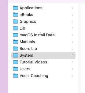

When you say 'USB drive' do you mean the exact same USB stick I first installed OC Monterey with? cos that no longer exists. I've rebuilt it twice to install on my 2 other Macs. Attached is the directory of the hard drive 'Content'. The Applications, Lib, System & Users folders seem to be copies of the System SSD (except Library is truncated to Lib). I assume the EFI is not visible at the desktop level. BTW the 'Content' drive appears in the startup disk options.
