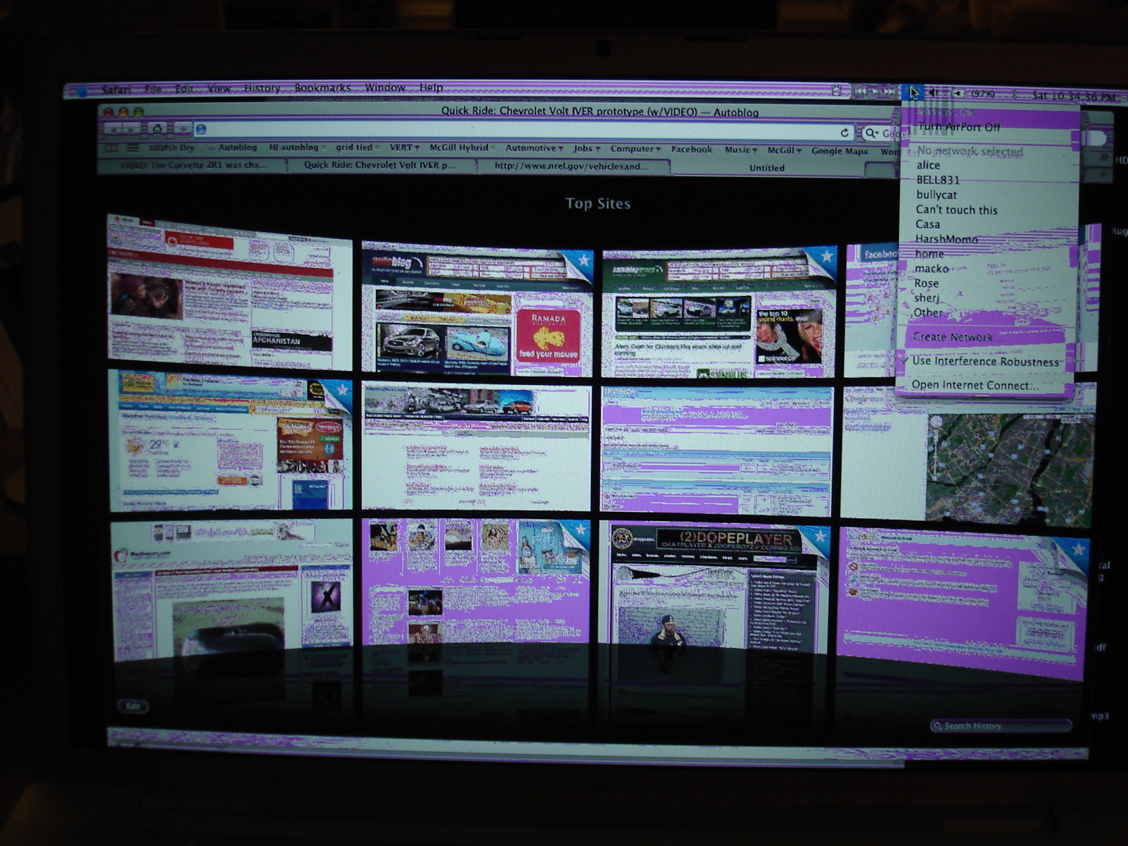

just to update that the problem has reoccurred several times tonight. Once I just got the pink lines scrambled all over the screen which lasted for a minute or so, with the computer unresponsive, and then it was okay after about a minute. Just now it happened again, but the computer remained unresponsive for a while, so i restarted. Again, on startup I got a kernal panic grey screen, but starting it up again after that worked okay. I'm going to look into going to an Apple store. This computer is no longer under warranty, the only thing I can hope for is that this is somehow related to the NVIDIA graphics card. Does that sound at all possible?
here is a photo of the screen with all the pink stuff. The computer froze when the pink stuff came up. My impression of the NVIDIA failures was that the computer would continue to function but with distorted video. In my case though, the computer freezes, does this suggest that it's something other than a dying graphics card?
I've booked an appointment at the local Genius bar on Monday, so any background information on this would be greatly appreciated!
They have a specific "nVidia failure test" they run at the store. It's got its own repair code and everything. (I had to take my late-2007 MBP in this week - no video at all). You won't have to convince them if it really is a problem with the nvidia chip.
Graphics cards going bad can have all sorts of odd effects on the OS, depending on how the driver reacts to the dying card. I'd say you have the 8600 issue. Graphics corruption, repeated kernel panics referencing Nvidia kexts, etc. Tell them you need the 8600M test done, it almost certainly will come up positive. If it does, you get a logic board swap on Nvidia's dime.
For this model of MBP, Apple has extended warranty even beyond AppleCare due to the faulty Nvidia chips. If you go in and it is as obvious to the Geniuses that it is a GPU problem as it is to us, you will have a fresh logic board in about 3 days.
Good luck!
Yeah this sounds like it's the cause of the problem. Apple will replace it for free. It's a widespread problem.
Okay thanks a lot for all the replies, this is comforting. Wasn't looking forward to footing the bill if this was something else. My girlfriend's also got a MBP, I guess we'll be keeping our eyes pealed for anything like this.
