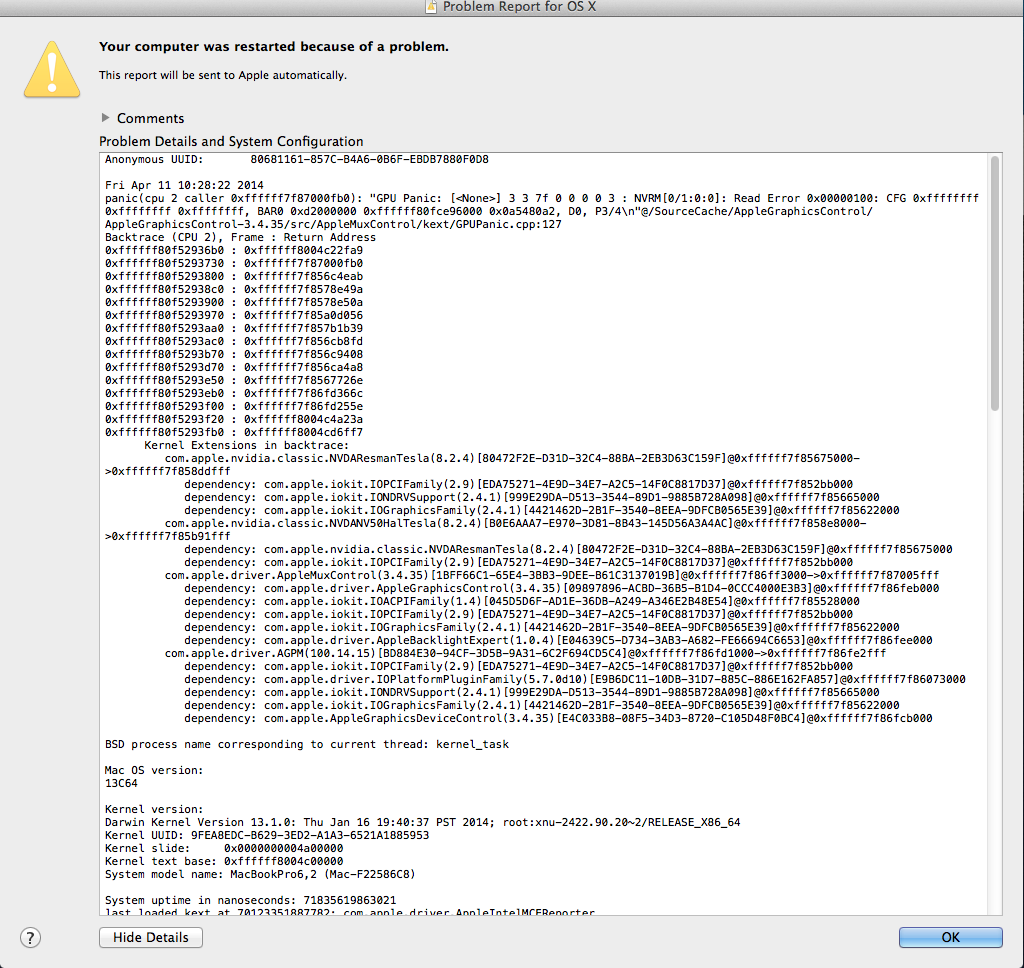

don't know where to post this. having constant KP on my mid-2010 15" MBP! i've only notice this in the last few months (maybe) when I am working in either FCP X or Motion x. Sometimes youtube will also trigger it. but, i wanna post it on here because I wanna do something with Motion X and the computer keeps rebooting because of this.
what do you guys think is the problem base on the screenshot of the KP message?
thanks for any input!
Its GPU related - I see a specific reference to "GPUPanic" in the output, and multiple references to "NVDA" and "AppleGraphicsControl". May need to reinstall the OS from scratch and see if that resolves the issue, since you can't simply update the graphics drivers like you can in Windows.
Sounds like you are having the notorious Mid2010 15" MBP GT330 problems. The best thing I can recommend for you is to try to take it into the Apple Store. They had a repair extension for up to 3 years from date of purchase to replace the logic board due to this issue. If you are outside of that, there's not a whole lot you can do. I personally own one that does the same thing and I'm outside of that 3 years from DOP.
Here's the link for the Apple repair
http://support.apple.com/kb/TS4088?viewlocale=en_US&locale=en_US

Well, the kernel panic is caused by the GPU. It usually occurs when the dGPU is in use and is being stressed (thus your situation with Motion X). For an immediate solution, just download gfxCardStatus and set it to force iGPU. That'll cut you down to the Intel HD Graphics but there won't be any kernel panics.

Also, it isn't always with stress. Sometimes, I get kernel panic just running Chrome + VLC. Sometimes, it occurs right after boot as I'm closing startup apps to switch to the iGPU. Other times, I can play RCT3 for half an hour before a kernel panic. I think the best way to put it is that if you use the dGPU, you'll get a kernel panic.
