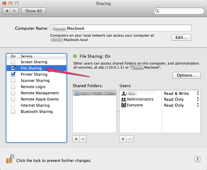

Like others mentioned, the best way would be a central server or NAS device. But if you don't want to spend the money/time on that, it can be done with OS X existing file sharing.
Go to the Sharing pane in System Prefs and turn on file sharing, then add the folders you want to share and add the users you want to share them with. You will need to do this with all ten machines. Then each machine would have a list in the Finder shared section of all the other machines and the folder shared from each machine. So every machine would have a list of the other nine systems on there.
Not ideal or pretty, but it would work and is free.

On each machine you need to click the plus sign (blue arrow here) to add each user you want to see the share on that machine.

That is correct. It does not matter if they are on wired or wireless, and there is no way to differentiate that way in sharing. Anybody on the network can see the shared folders if you have it setup that way.
Look at my screen shot and you will see the default config allows anybody (Everyone) to Read Only. If you don't want that, change "Everyone" to no access and then add users one by one and give them full read/write access if that is what you want (and it sounds like you do). This way nobody on the network will see any of the shared folders unless you have given them permission.
I realize that, and it's precisely where I'm stuck. I only see users from whatever computer I'm working with, but the idea is to allow users from other computers. So for example, Molly on Receptionist Computer needs access to Technicians on Tech Desk Computer. You know, each computer has access to each other computer, but in a way that doesn't allow just anyone with wireless access.
You need to manually add each user. Read this article in the section "Sharing with other people" in the last paragraph where it talks about adding a "New Person."
Like I mentioned above, change Everyone to "no access" and that will limit access only to people you add manually.
There are endless combinations here and you can fine tune it to exactly what you want.
You could setup the Tech machine so only Molly has access to it and further restrict Molly to only certain folders, for example.
Maybe write down what machines you have and who/how you want them to have access so you can visualize what you want... then run around to each machine and set it up.
Like I said in my first post, this is not pretty or necessarily the easiest to manage, but for zero money and a little work it will do exactly what you want.

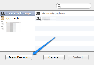

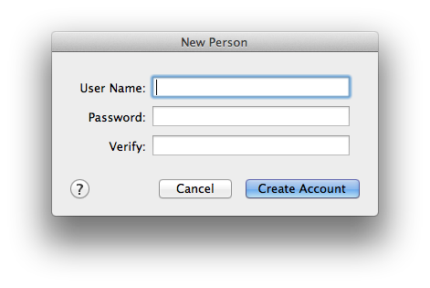

If you click New Person like in my screenshot above, you can manually add the user in there and it will create a new "share only" account. You don't need to even go into Users & Groups.

Like Frejazzman mentioned, you are not on a domain (local server), so you need to add each user manually to every machine. There will not be a list to choose from. If you click plus then New Person (blue arrow on my screen cap), then you will get the screen below. Enter a user name and password for each person you want to allow in the share. You can just make these up... does not have to be the same as their real account on their machine.
If you do not require fine grain control of this, you can just turn off all sharing for "Everyone", then add one account in New Person and call it let's say "share"... then make up a password. Now give that one account the folder and read write access you want. Then go to each computer you want to share files from and repeat this.
Now go to each computer you want to allow to access shared files and click each machine listed in shared in Finder and you will be prompted for the user name "share" and your password you made up.
You can add as many shared accounts as you want on each machine. If one will do it, like I described, then that is all you need.
You can see if you want to get elaborate you can. You could have Sally-A access only /Documents/schedules folder on machines B and C but not D. Have Mary-B access the entire /Documents folder on C, D, and E... and so on.

Yes, that would work, but with multiple machines and users that is going to get very confusing. I am suggesting adding one shared account of the same name to each machine so all anybody needs to know is that one name and password.
I will assume you want all users involved in this to see each others folders.

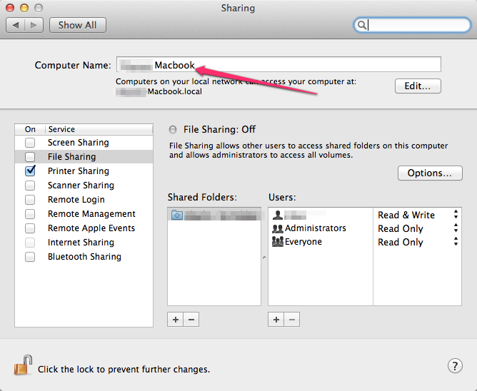

When you turn on File Sharing everybody on the local network will see those machines in the Finder under Shared. What they will see is the "Computer Name" like in my screenshot. So change each machine involved to something meaningful. Like "Mary in Accounting" or "Doug in Sales."
Now in that same Sharing screen on each computer you want to share from, change Everyone to no access, then manually add (posts 9+12 above) one shared user account and add the folders you want shared from that machine. For simplicity, make it the exact same user name and PW on each machine. For our example the user name is Q with password "test."
Computer X (Mary in Accounting) has user A + (shared) user Q
Computer Y (Doug in Sales) has user B + (shared) user Q
Computer Z (Bob in Marketing) has user C + (shared) user Q
When you are done it will look like my example above. You will give the user name Q and PW test to only those you want to have access to the folders. It can be anybody on the local network, not just Mary Doug, and Bob.
Okay, now anybody on the local network will see "Mary in Accounting" etc. (all three machines) in the shared section of their Finder. They will be listed there one after the other. If Mary uses wifi at Starbucks everybody at Starbucks can see the "Mary in Accounting" as a shared resource. Anybody at Starbucks that clicks on her share will be asked for the user name and password, which of course they will not have... so Mary is safe.
Back to the office. Like I said everybody can see all three machines in their Finder. Anybody in the office can click to access and they will get the user name and PW prompt. People you gave the user name and PW to will just enter it and they can access Mary's shared folders, for example
Anybody local with the Q/test UN/PW combo can access the shared folders on one or all of these three machines.
