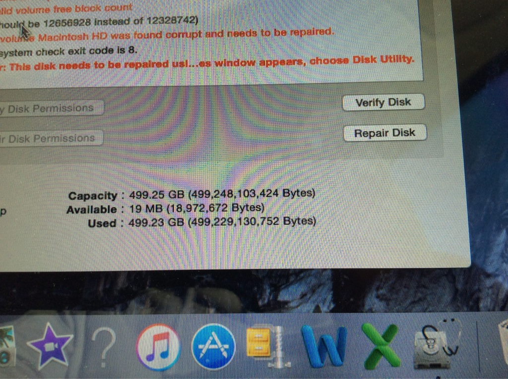

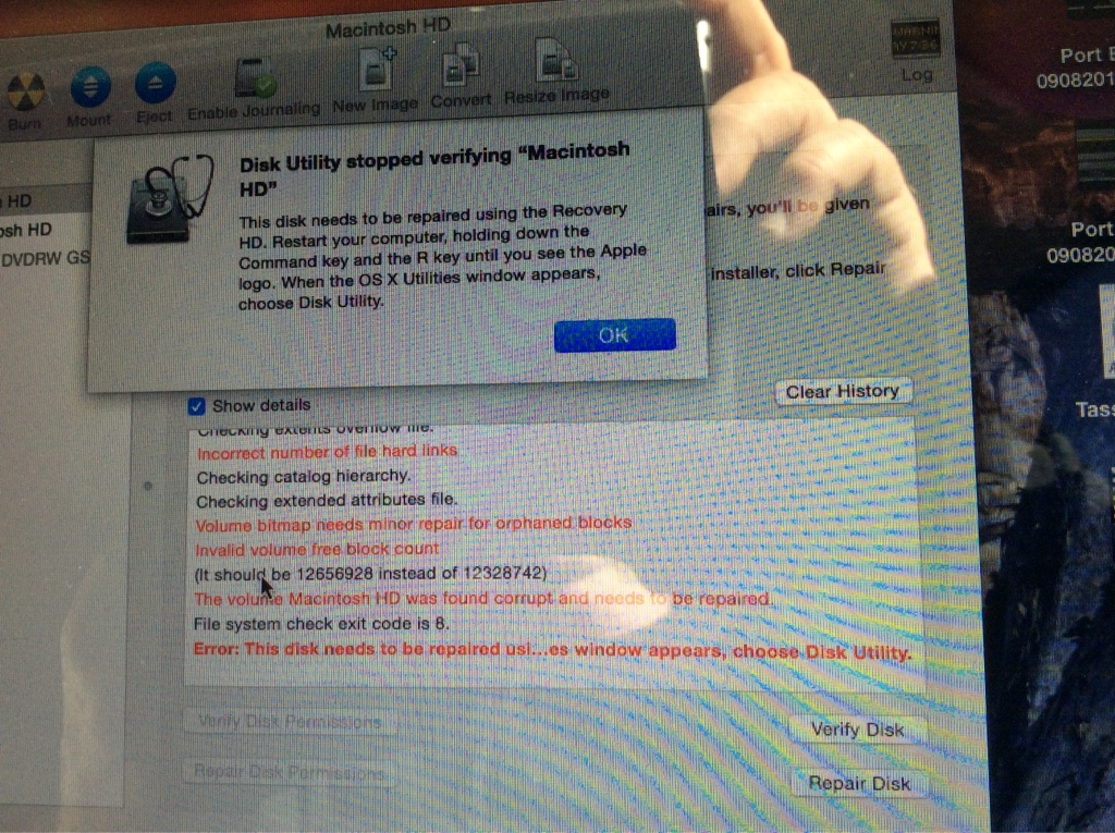

Your out of drive space which isn't good for any machine. That is your issue
How do I fix this and what about the red writing that says disk needs to be repaired
Remove some stuff. The red error is a false error caused by the inability to run correctly. Once you've made some space re run the utility then click on repair and it'll solve any errors
You can't fix the disk until you make some space on it (you should always try to leave 10-20% free anyway just for best performance) You will have to delete some stuff, try and back it up first to an external drive if you can.
Back up your machine first, and then start removing files that you don't need or want any longer.
To find the large files, download and use OmniDiskSweeper. It will provide a sorted list of what's consuming your space.

Given that the OP only has 19MB disk space free, it will be difficult to download and install something like OmniDiskSweeper. Sort of a chicken and egg problem.
You're right, he's in a critically low situation, I thought it would have been good for him to identify the biggest files, but downloading/installing an app at this point is not feasible.

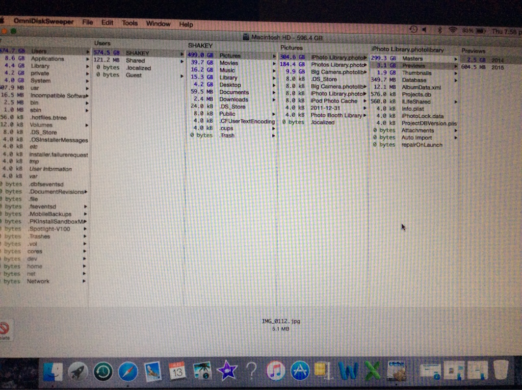

Since you have free up some space now, you should go download OmniDiskSweeper. Identify the files you don't need or no longer need and back it up.
I would not recommend messing with hidden files because you don't know what it is and very likely to delete some core files. You will probably mess up with the OS too.
Well ladies and gents.
I down loaded omnidisksweeper, and it opened my eyes.
Three quick questions.
1. If I don't have any pics in iPhoto or trash, where are the pics/movies that this program has located ?
2. If I want to delete some or all of these, which column do I delete from ?
3. If they were something that I wanted to keep, can I just drag and drop into an external hard drive ?
Sorry to be a pain but this is all new and a little frightening to me.
They are stored in the iPhoto's folder
Open finder and then your home folder. Pictures and it's in there.
If you control click the iPhoto file which is a package of sorts and then click show package contents you get more folders. Inside originals will be all what your looking for.
I wouldn't going into iPhoto library and mess with it because you can easily mess up/corrupt it (I've tried that). Your biggest issue is your iPhoto library. Do you need all those photos into one library? If not then can you rebuild the one that you don't need it and put it in an external drive?
Have you every thought of using the new Photo app rather than iPhoto because Apple is phasing it out.
How about those movies? Do you need it in your internal drive? Can those be moved to external?

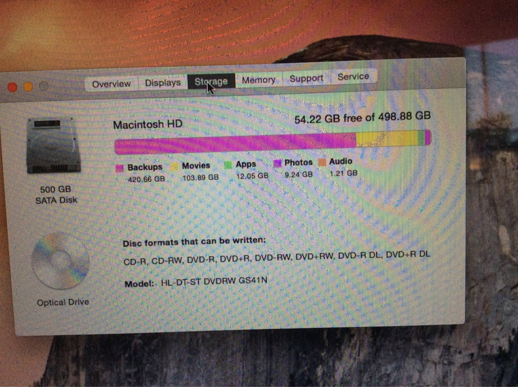

Now my MacBook is still slow and this is the latest snap shot of usage. Why is there so much space taken up by backup
Thanks for all the help thus far. I used omnidisksweeper and removed lots and lots of movies and picture.
I believe that the backup storage you are seeing is local Time Machine backups. Go into System Preferences->Time Machine, toggle Time Machine off and then back on. Now see if the storage used has been reduced.
