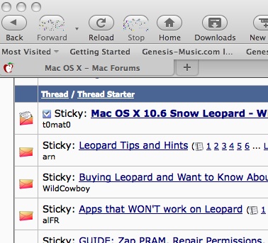

the problem is getting worse and worse. now even iTunes crashes, and when I tried to open Safari and iTunes at the same time, they both crashed. The other day, I ran about 7 apps at once to test if it was the RAM that was defective, and they ran fine, only for the computer to crash a couple of hours later. (i will refer to the crashing as a kernal panic henceforth because the computer doesn't just crash, it gives me the kernal panic warning.)
and now even the graphics are screwing up in firefox. when i booted it back up the toolbar menu looks like this (see attachment).
that is definitely a hardware problem, from the last screenshot I would say the gfx chip is dying. This would also explain the kernel panics

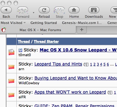

Try to reset the PRAM.
