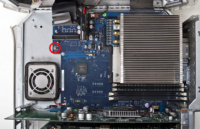

My Mac G4 (mirror doors) works fine and I appreciate it. Lately, the machine is difficult to turn on. I press the button, the light briefly flashes, nothing happens. I pull out the power cord from the socket, put it back in, press the button, the light briefly flashes, nothing else happens. I go through this process several times (in about 30 minutes), and finally the Mac starts and other than the date and time must be reset, everything works as normal. For 2-3 days the Mac will turn on without problems. But then again, it becomes difficult. The battery is about 10 months old.
I suspect it's the power supply. The local Mac authority shop will not do it, because Apple no longer makes power supplies for my vintage Mac. Trouble-shooting and repairing Mac problems are new to me. I found a supplier that sells the required power supply for $250. Before buying I'd like to make sure that is the problem.
I appreciate all help, suggestions, and advice.

Try this:
1. Power the MDD down
2. Remove the logic board battery and leave it out for 10-15 min.
3. Put the battery back in and press the PMU button just once.
4. It should startup fine now.
To me this sounds very much like a sketchy PMU that needs to be reset. They can easily crash themselves at times and will also crash if you press that PMU button more than one. You want to do one good press where you hold it down for about 1 second and then release.
The PMU reset button location is circled in the image below:
