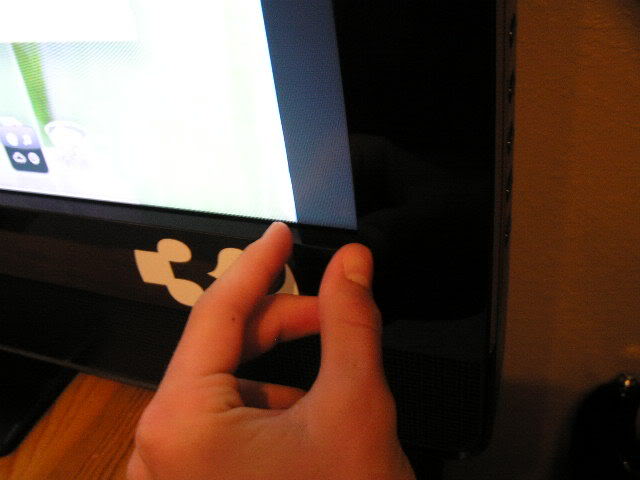

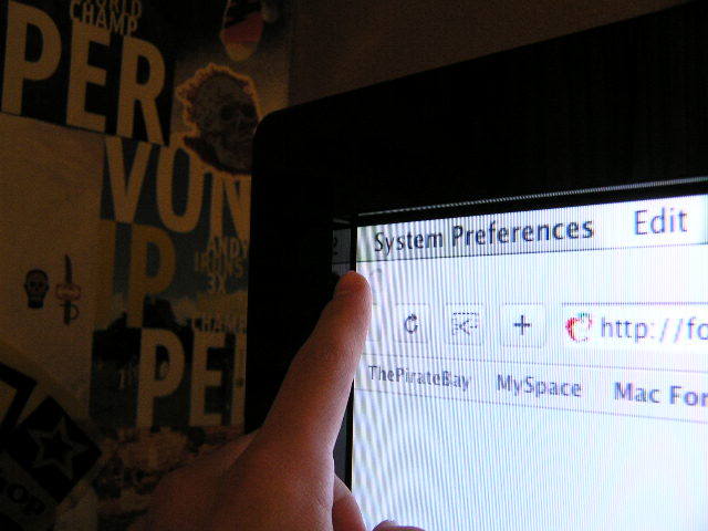

The highest res outputted from this tv is 1366x768, unfortunately i can only output to 1280 x 720 (which is still nice being 720p but not as good as the extra pixels would look)
Anyways, ive dowloaded SwitchResX and tried that but no luck, i made my own custom res but i still have about an inch of blackness to the right side of my picture and the apple in the top bar and about an inch is cut off too (like the whole screen is moved to the left)
