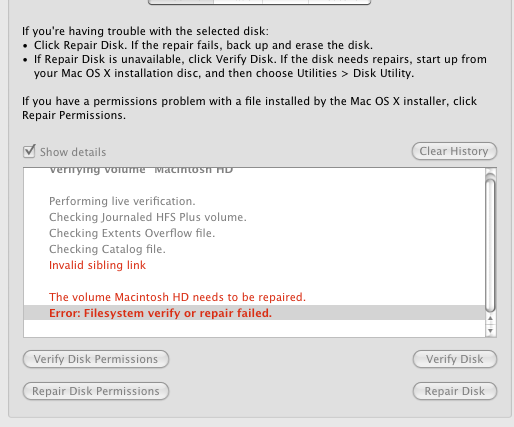

Thanks to you both - sounds very plausible. I did not restart the drives (they are on 24h except the one that seems to be dying, which I turned off without ejecting earlier today), and I did run verify on the internal disc, which gave the attached failure as a result. Computer working fine now, should I do anything else? What does the stuff disc utility reports mean?
Thanks again.
It says "Needs to be repaired"

Invalid sibling links tend to be a little bit more of an issue than most other Disk corruption. You will probably find that Disk Utility won't fix it (and nor will FSCK in single user mode, as these are one and the same). If that does happen, see if you can find someone to borrow a copy of Diskwarrior of off. That's pretty good at sorting out Invalid Sibling Links
