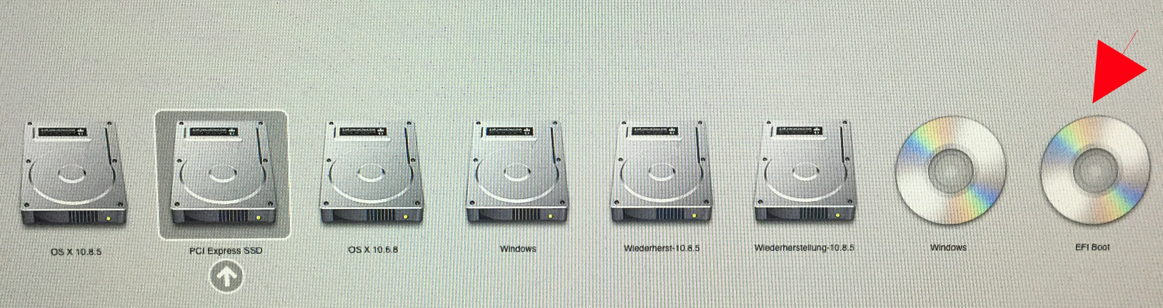

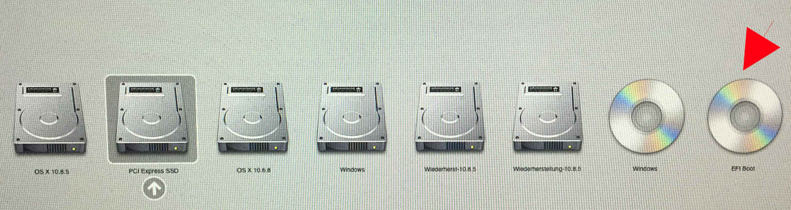

I don't know. I had problems with the latest iteration of boot camp assistant, and I ran into the same problems as the OP. The latest iteration of boot camp assistant supports only 64 bit versions of Win 7 or Win 8 according to Apple's own documentation. There are lot of factors which made my installation difficult, and technical prowess was not one of them, I assure you. I always follow directions to a tee, and this time, it was just a disaster. So if you were able to work bootcamp with your cMP, good for you, but if you were using the exact same boot camp assistant, the same cMP 4,1 and the latest iteration of OS X, you would have run into the same problems I did. So I love you all for supporting the OS X community, but HOOYE to all of you that think this is just a cake walk and I must have made some rookie mistake reading the directions! 😛
Yeah, i installed Windows 7 (64 Bit) a long time ago with Boot Camp 4.x drivers, never tried Boot Camp 5 on the Mac Pro. Howsoever a 32 Bit Version of Windows makes no sense when even the GPU has 2 GBytes of memory, as in my case. My once installed Windows XP 32 Bit did not work correctly since i have a GPU with 2 GB.
Did you try to install Windows 7 direct to a drive without Boot Camp? And let the Windows Setup format the drive? If I remember correctly, i've chosen the EFI Boot part of the Windows 7 (64 Bit) DVD.
If you read my original post, I did not do that. I formatted a 1TB drive on Bay 3 of my computer (not important which bay, just that I did use one of the bays) using Win 8.1 Pro x64 through the Command Prompt (Admin) in VMWare Fusion. I made a boot partition as well as a NTSF partition. I made a .wim image of that Win 8.1 Pro x64 machine and stored in a folder I made c:\wim. Then I copied that image to the freshly formatted 1TB drive I just made in the previous step. When I finished that, I rebooted my 4,1 by pressing the Alt/Option key and selecting 'Windows' as the startup disk. After that, I installed the boot camp drivers, and finally updated the NVIDIA drivers through their website to match my GTX 980. Voila, functional MacPro running Win 8.1 Pro x64 natively. Very fast, very smooth.
