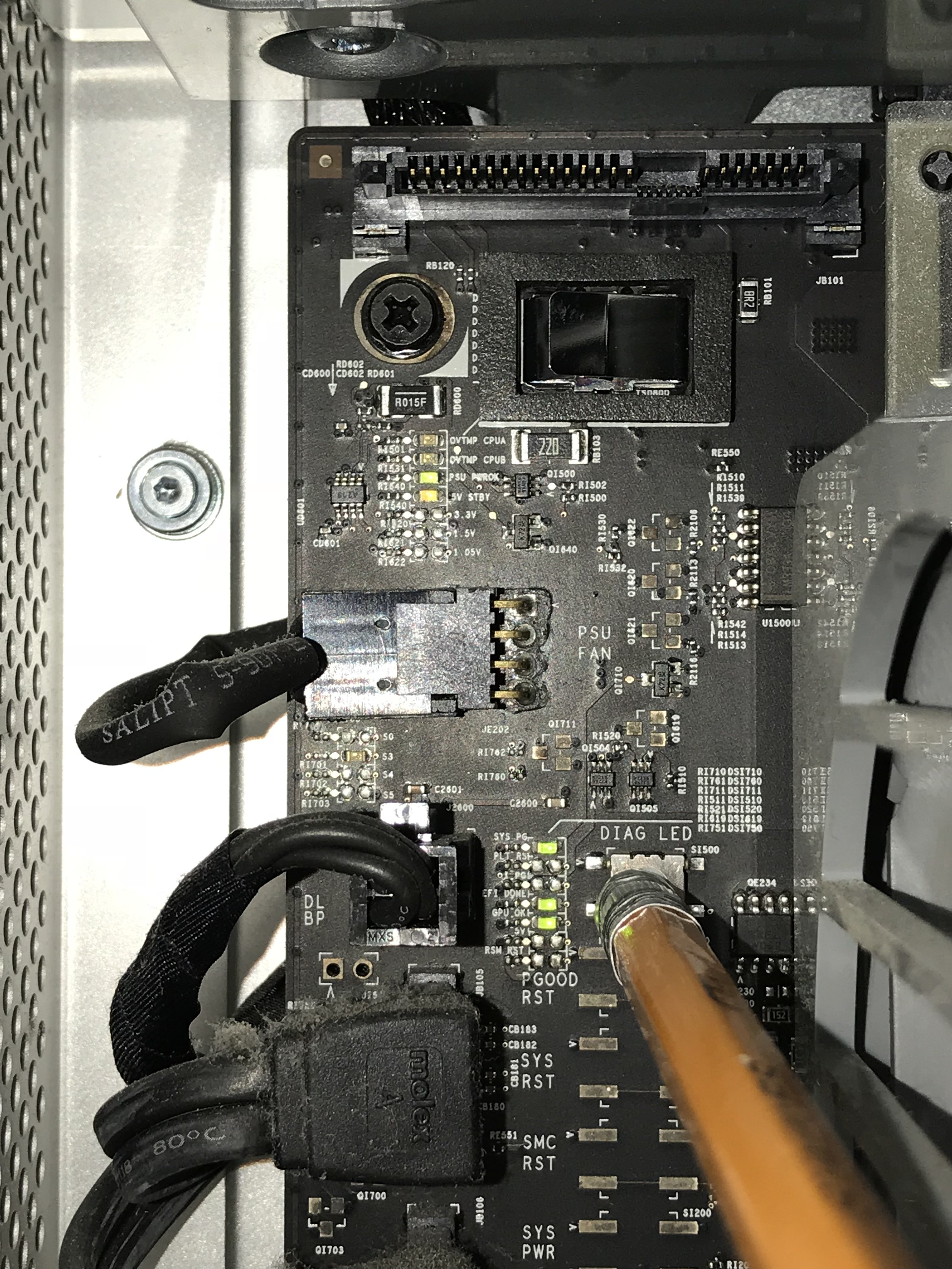

Hello all, having a bit of a head scratcher with a recently purchased 2010 Mac Pro. The computer powers on, all fans run including GPU, but will not chime or past POST. Power light on front panel is solid as well.
What seemed to trigger this problem was unplugging the power from the wall, moving the computer from the left side of the desk to the right, and plugging it back in. After that, it would not work. Prior to moving it, everything worked well.

- Pressed diag LED button (see picture, not sure what these leds are telling me)
All of the above have yeilded the same results

LEDs look good. Following the troubleshooting steps in the service manual you are around step 7 or so. Step 8 is check fans for spinning. It does suggest if all LEDs are good but no chime to reset NVRAM. Might want to get the service manual and continue the troubleshooting procedure.
A 2008 PS cannot be used in 2010.
