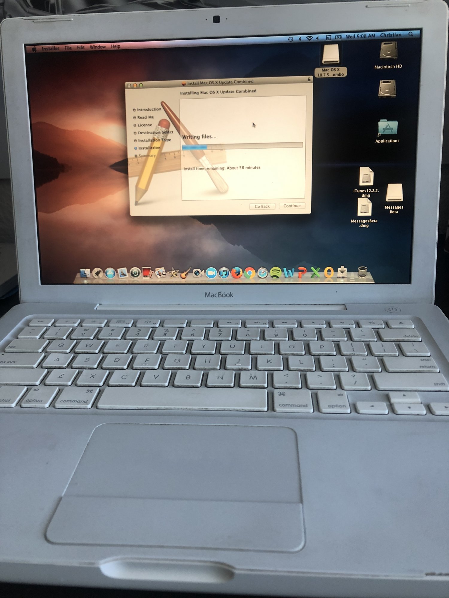

It doesn’t even show green when plugged in on the charger... I’ll try that right now, I went to the section for notebooks without T2 chip. One of my MacBooks (A1181 White) is updating from 10.7 to 10.7.5 right now, battery is done, it only turns on when plugged in. After it’s finished, i’ll try to fix this MacBook. Any other things I could try?

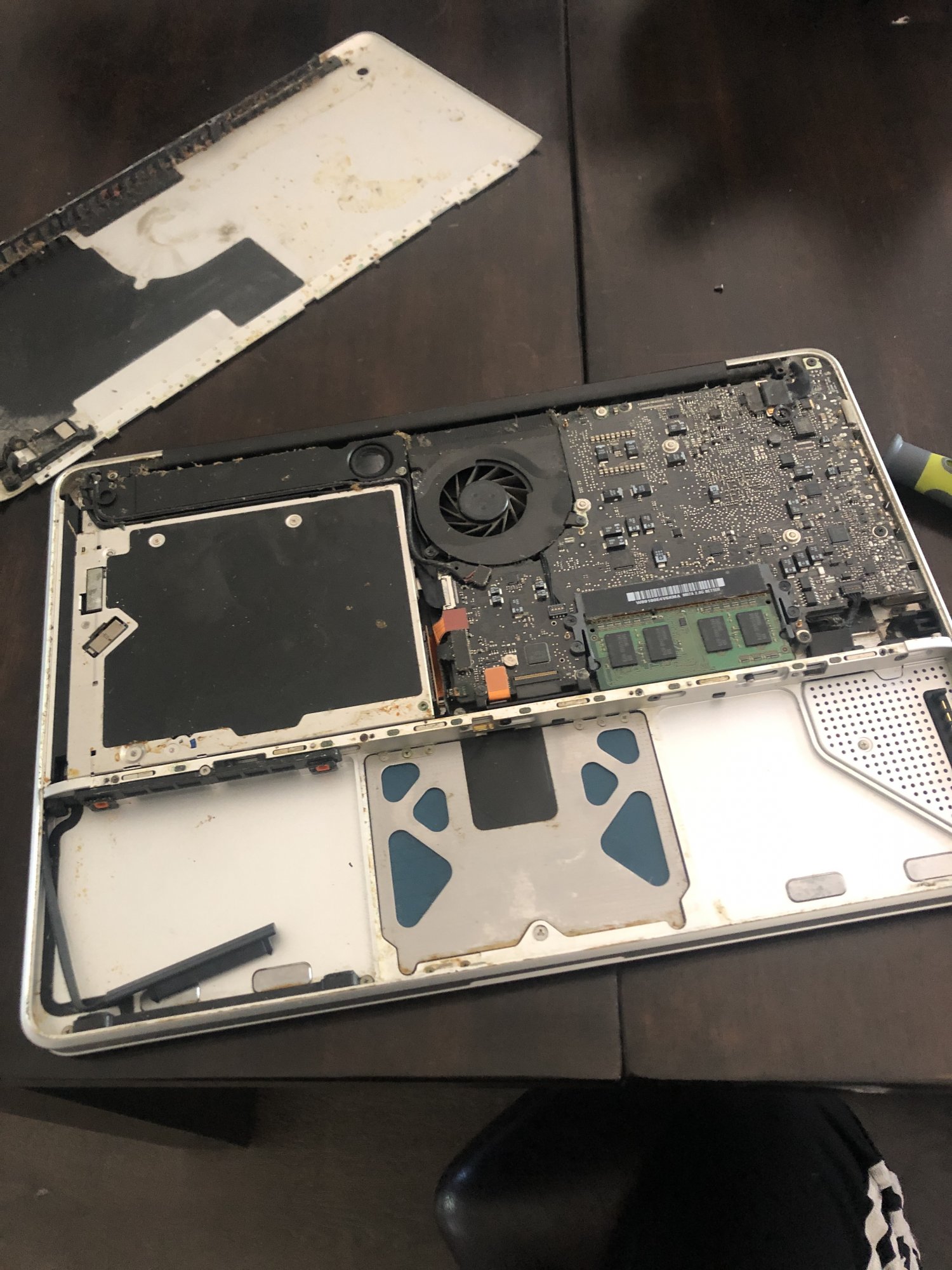

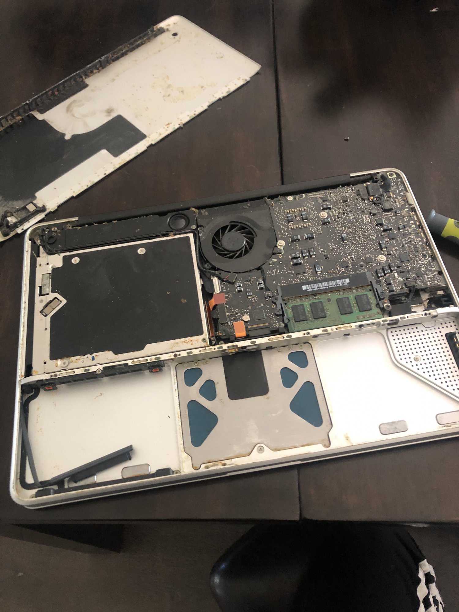

Dads working on a fan. I decided to do it myself. Didn’t look at the guides yet, I will. Already disassembled.. what do I do next?

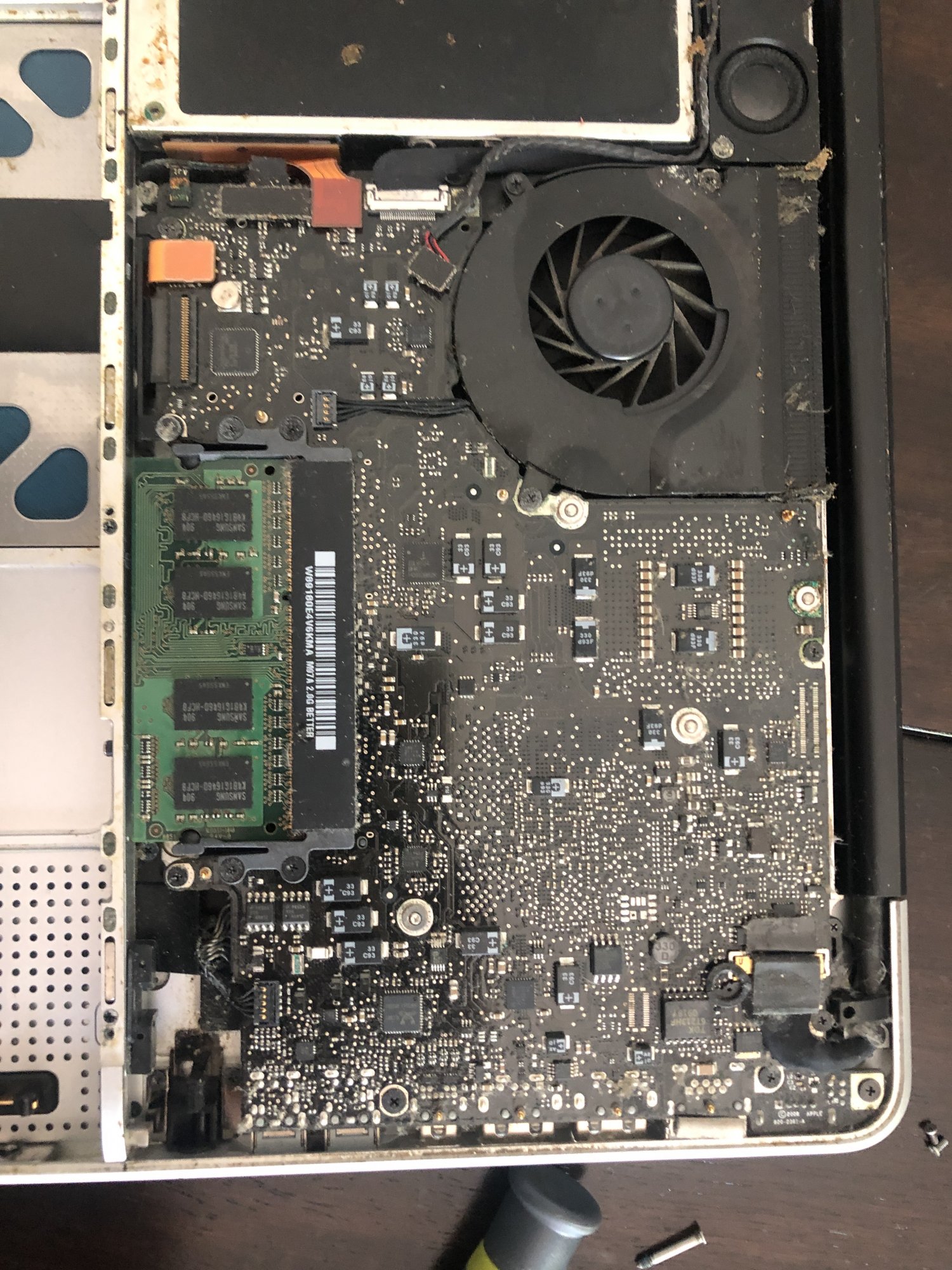

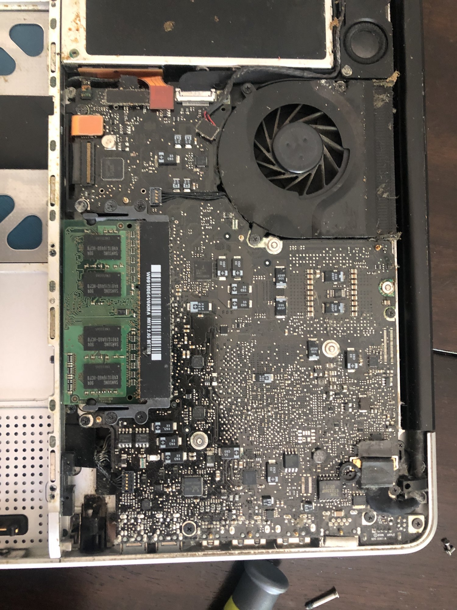

This mac is DISGUSTING... there’s this gross orange stuff everywhere, dust, it’s nasty. The photos I took were after i cleaned it up... What should I do?
From my experience cleaning up the A1181s I cleaned up and collected, I've found that the condition of the MacBook's insides is highly indicative of the condition of the living space of the person who owned it...
Anyway, congrats on being able to disassemble the MacBook; a much more daunting task compared to earlier models.
You'll have to look at the photo here: https://beetstech.com/blog/where-are-macbook-pro-unibody-power-on-pads-located#a1278L2008 and try to find the corresponding location of those two small contacts on your MacBook's motherboard. Plug in the motherboard to your MagSafe adapter and try to jump the two pads (i.e. bridge the gap between the two pads to create a circuit.
To jump the pads, try using a small precision flat head screwdriver. The metal has to make contact with both pads to start the Mac.
