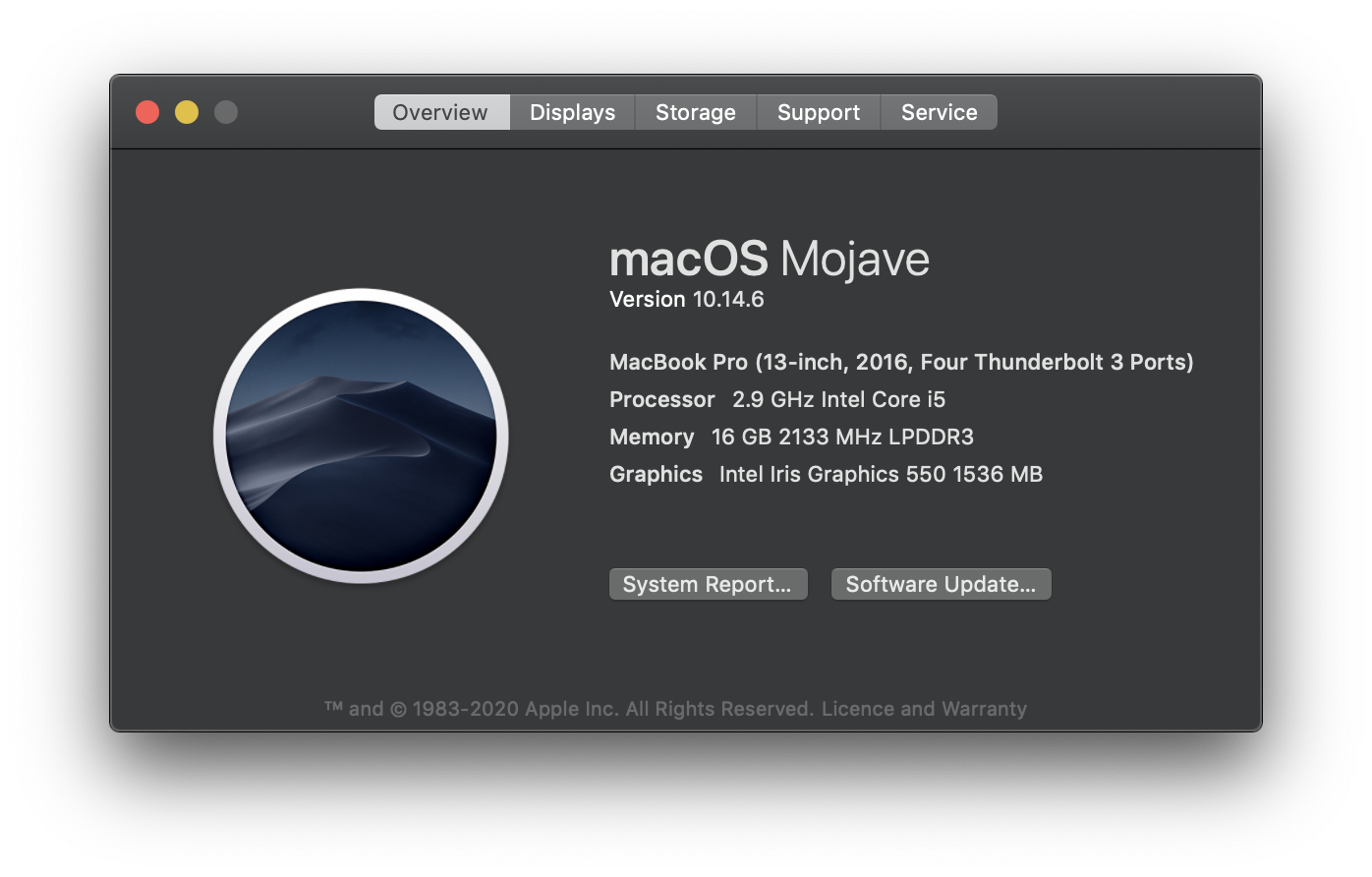

Today my Macbook Pro's camera stopped working which is a bit of a problem due to current world events and I have tried everything I can think of to see if just magically starts working again.
I have reset SMC, PRAM, installed all software updates and run the First Aid check in Disk Utility to see if that would repair permssions.
I have executed sudo killall VDCAssistant and reopened apps afterwards to see if that would work but nothing.
I have also ran Apple Diagnostic test (hold D when bootin up) and no issues were found with reference code: ADP000
What appears to happen when opening an app that needs the camera is the green light comes on but I get a black output, after 10 secs the green light goes off.
Has anyone seen this before and know how to fix it?
Here is a video of what happens -
Thanks
