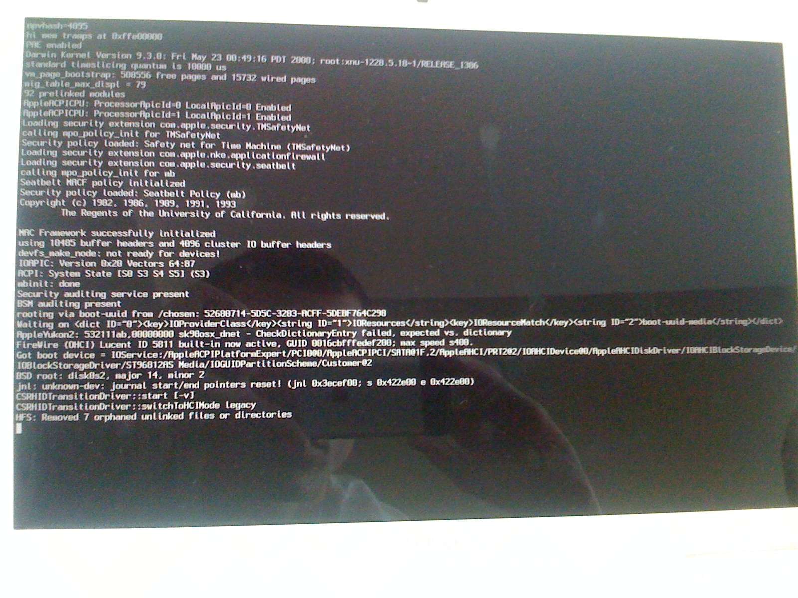

well, here's a pic of what happens when i boot and hold down "C" :

Ok, this is new to me it doesn't give you a process to check (probably because the panic is from quite early on), have you pulled the RAM and given it a try? I don't know if that would help, but it still could.

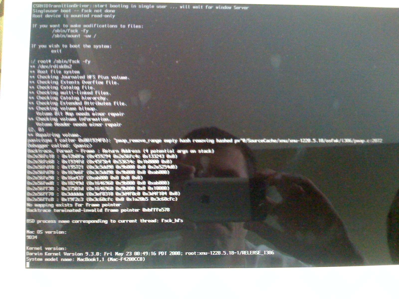

Before going and removing RAM, have you tried running FSCK? If there's a disk error it might help diagnose and fix the problem. Also you don't need the original Apple RAM yet, just pull one RAM stick out and see if it runs. If it still doesn't run swap out the one stick for the other. I still have no idea if it will work or not though... Damn that computer is being stubborn!
i have not tried FSCK yet. in fact, i've never done that. could you point me in the right direction?
thanks

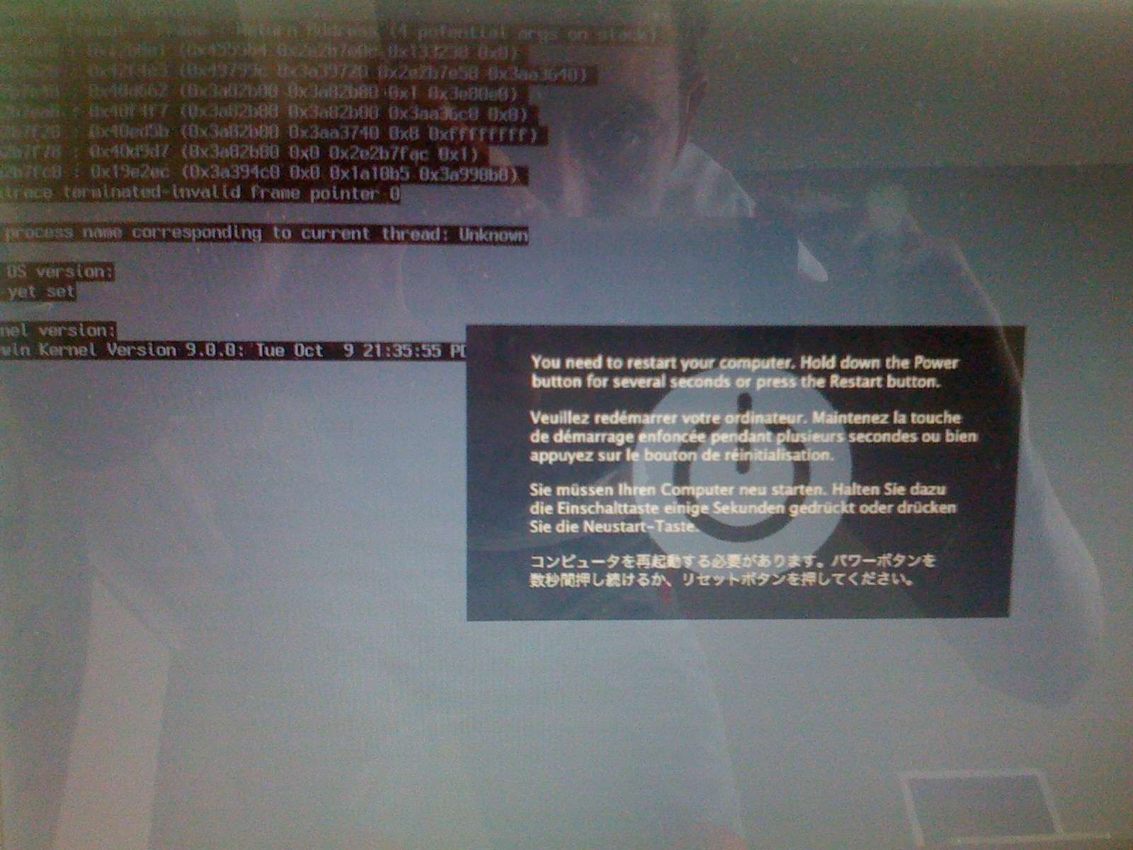

Sorry I haven't been able to keep up with the thread, I've been all over the place today but I'm glad to see you got fsck working. If I read that last pic correctly it was repairing the disk, but then fsck caused a KP? Damn that's weird. Sorry I'm not sure what to do.
yes, you read it correctly (sorry for the bad pic). i ran fsck again, and it said that the disk was OK. so i restarted, and bam! KP again. i don't think i can do much else to this machine, besides put back in it the apple ram and take it to the apple store
