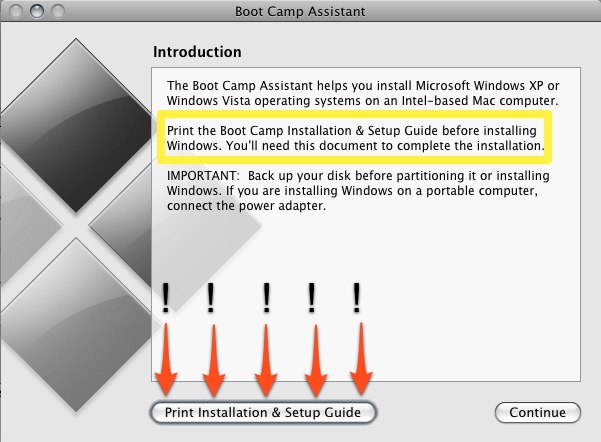

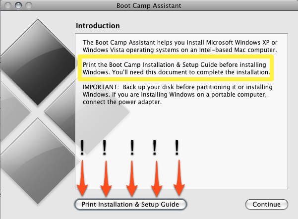

Print, read, & follow the Boot Camp & Installation Setup Guide. Works every time.
I did this. I had tried to set the windows partition to 24gb and had booted into the installer. When I got to the part about which partition I wanted to install on I had two choices neither of which came close to 24 gb ( about 100 gb each). So I tried to back out and see what was going on and, all it would do is go to "windows." so I used option on start up and found no mac partition.
