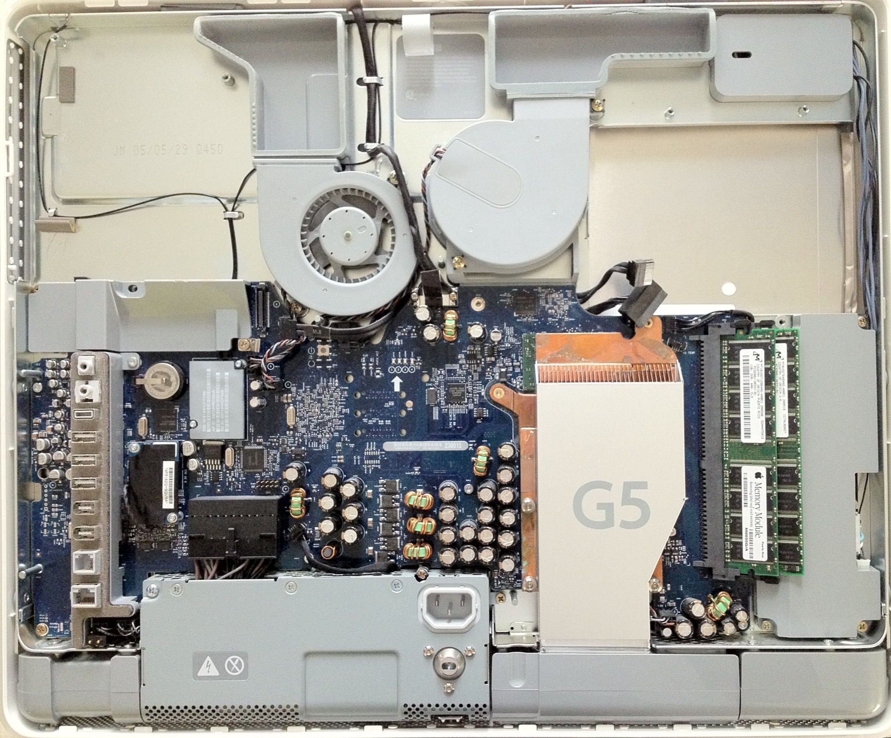

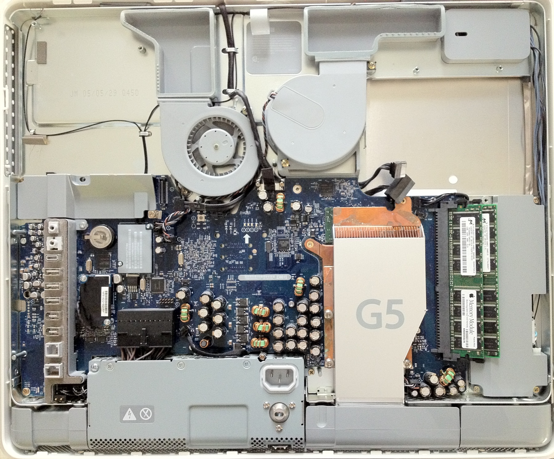

I've recently acquired this iMac G5 😀
It has no HDD and no optical drive 🙁

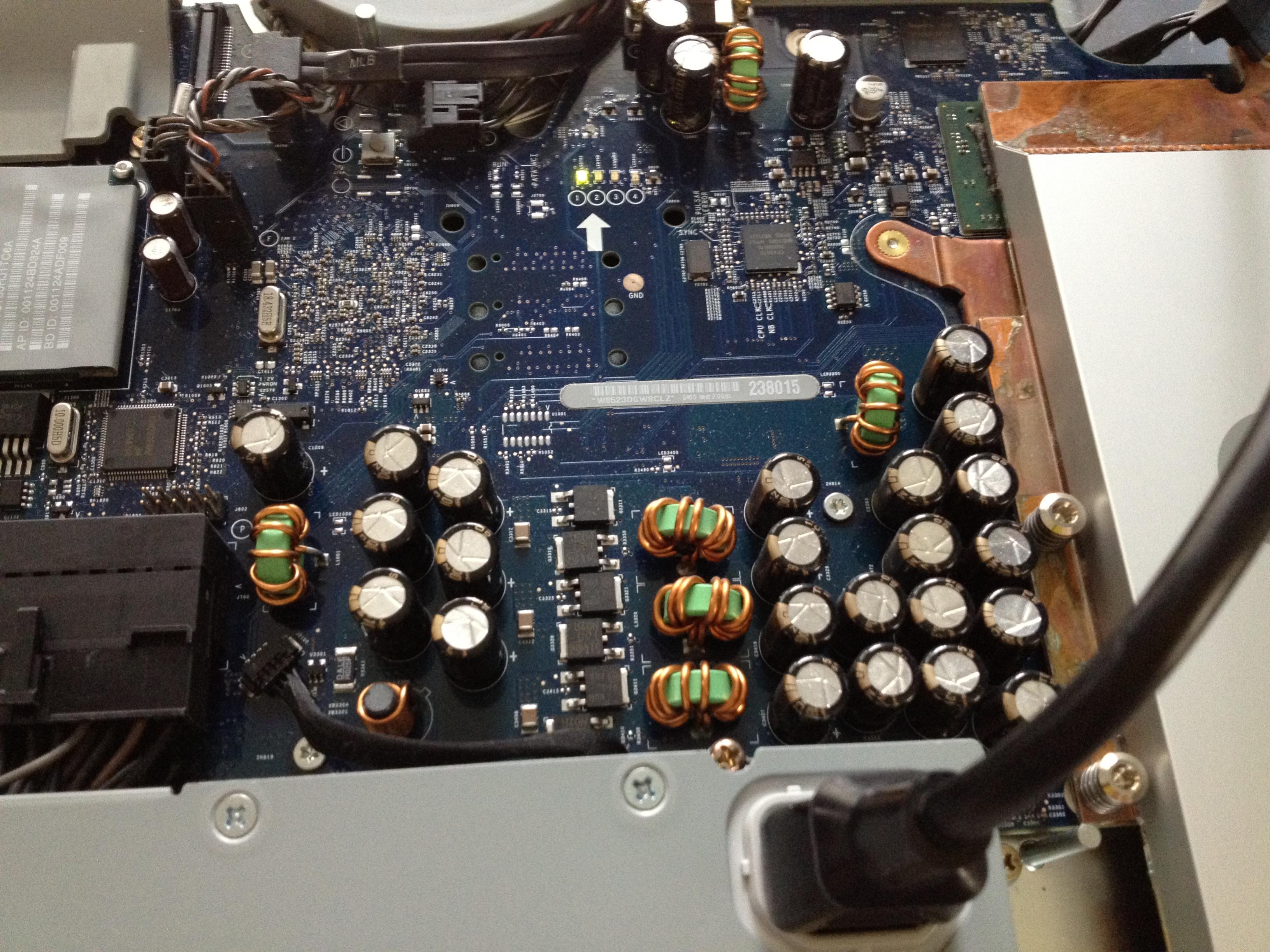

When I connect the power cable, the first LED lights up but the second LED just blinks
Is there any way I can boot up this mac with an external HDD?

And the capacitors appear fine

I just mentioned it because it appears there is chemical scaring on the copper plates of the mother board.
Don't think he has that problem.
I just opened the picture in a new tab and enlarged it, the Caps seem to be fine, no bulging.

The second light blinking is probably due to the fact that there is no disk to boot from, so don't worry too much yet.

EDIT 3: More on the internal LEDS(Apple site)
To help you even more.
Are you having problems with your Apple iMac G5 17 and 20 inch consumer, university, or student models? Does your iMac turn off by itself? Are you seeing strange graphics on the video screen? Is it to the point where it doesn’t even turn on anymore? Is it running hot and the fans sound like a vacuum cleaner?
There's a link in the above about power issues as well but I will say here again, depends on the model though, if it's an isight imac this does NOT apply:
iMac G5: Troubleshooting when your computer won't turn on
And, next time if you need help please include the model number, without it we just have to guess, if we know the model number we know the year, especially the first iMac G5's had Caps and Power supply problems.
