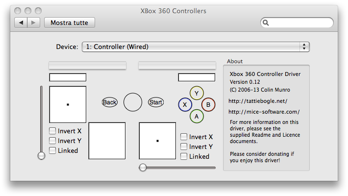

Download 360Controller v0.12 for Leopard PowerPC (Take 2) attached.
Edit (April 16th, 2018): Fixed issue in uninstaller not unloading LaunchDaemon script correctly.
__
I was able to build for PowerPC once all of the Xcode project files had been set to target ppc and 10.5 specifically. The driver developer's code signing profile also had to be disabled.
The Iceberg package manager described in the Read Me wasn't compatible with the installation project, but the same developer (Stéphane Sudre) had released an older package manager which worked for this: Packages 1.1.3 (PowerPC)
I then wrote an uninstaller script, adapted from @swamprock's Tiger Sierra installation shell scripts.
I have tested installation/uninstallation of the drivers on my PowerBook G4 DLSD 15" [and Dual G5], but I don't have a 360 controller to test if any of this actually works...
Good luck!
Good news is that it works and recognizes my controller as good as the previous version. Bad news is that it brought no differences in games like Midnight Mansion or Rayman 3. For the latter it can be ok with only one analog stick, but for the former the stock key mapping is very bad. I think it has to do with SDL library which the game is based on.
Anyway thanks a lot, @AphoticD , the installation package you made is so well done that it looks like the original one 😀 I now have latest driver available for my Xbox 360 controller on my iBook 🙂
