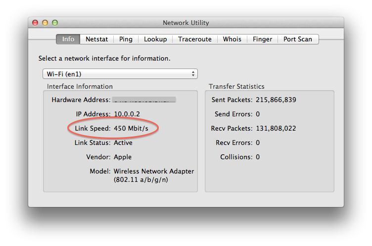

Wireless is not on par with ethernet whatsoever. Wireless-N can reach a theoretical maximum of 450Mbps in perfect conditions( which pretty much only ever happens in a lab), whereas ethernet can do 1000Mbps easily and is mostly limited by read-write speeds more than the network.
