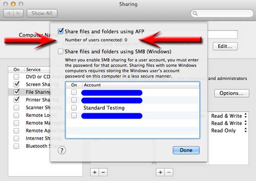

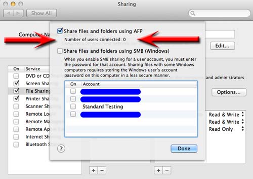

Another way to see who might be viewing your data
I know this is a rather old thread but I think the following info might be useful for folks wondering about who might have access to their drives/files/computer(s). I think this info is available at least back to Snow Leopard, maybe further back. Hope it helps. 🙂
