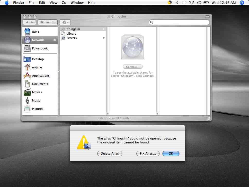

I have one airport express and both my Mac and my partner's pc using XP Pro can use it to access the internet wirelessly with no problems.
However I want to network our computers so we can exchange files with each other. When I click on Network in the Finder I see his pc (chingsim) but every time I hit the connect button I get this stupid error message (screen shot below). So I try to "fix alias" but it asks me to choose a location I would like chingsim to access, when I do this nothing happens and I am still unable to network both our computers.
Any advice would be great thanks.

Possible fix:
Optional: set up your Mac and his PC to use predefined IP addresses (*) so that you both have the same IP all the time. That just makes this next step easier....
Next step: in Finder, hit ⌘-K to connect to another system. Type in his IP address (either static, if you did the above step, or whatever he currently has, if you didn't).
That should work.
Odds are, because you're likely using DHCP, you guys alternate on getting the same two IP addresses (or more, if other systems share your AirPort), so the Network link's name lookup is out-of date.
(*) Go to System Preferences->Network->AirPort->TCP/IP->Configure IPv4 set to "Using DHCP with manual address", then enter something, like your AirPort's IP plus 1, for example AirPort=192.168.1.100 -> Yours=192.168.1.101), then set the AirPort to serve DHCP to addresses two above that (e.g., starting with, say, 192.168.1.103), and, however it's done on XP, set your partner's system to use the IP address above yours but below the ones handed out by DHCP. If it 's only ever the two of you, you can disable DHCP on the AirPort altogether.
You should be:
Finder -> Go -> Connect To Server
And then type in the server address:
smb://192.168.0.3
or whatever your IP is of your PC.

True, that's a completely different approach to what I suggested above. 😉
