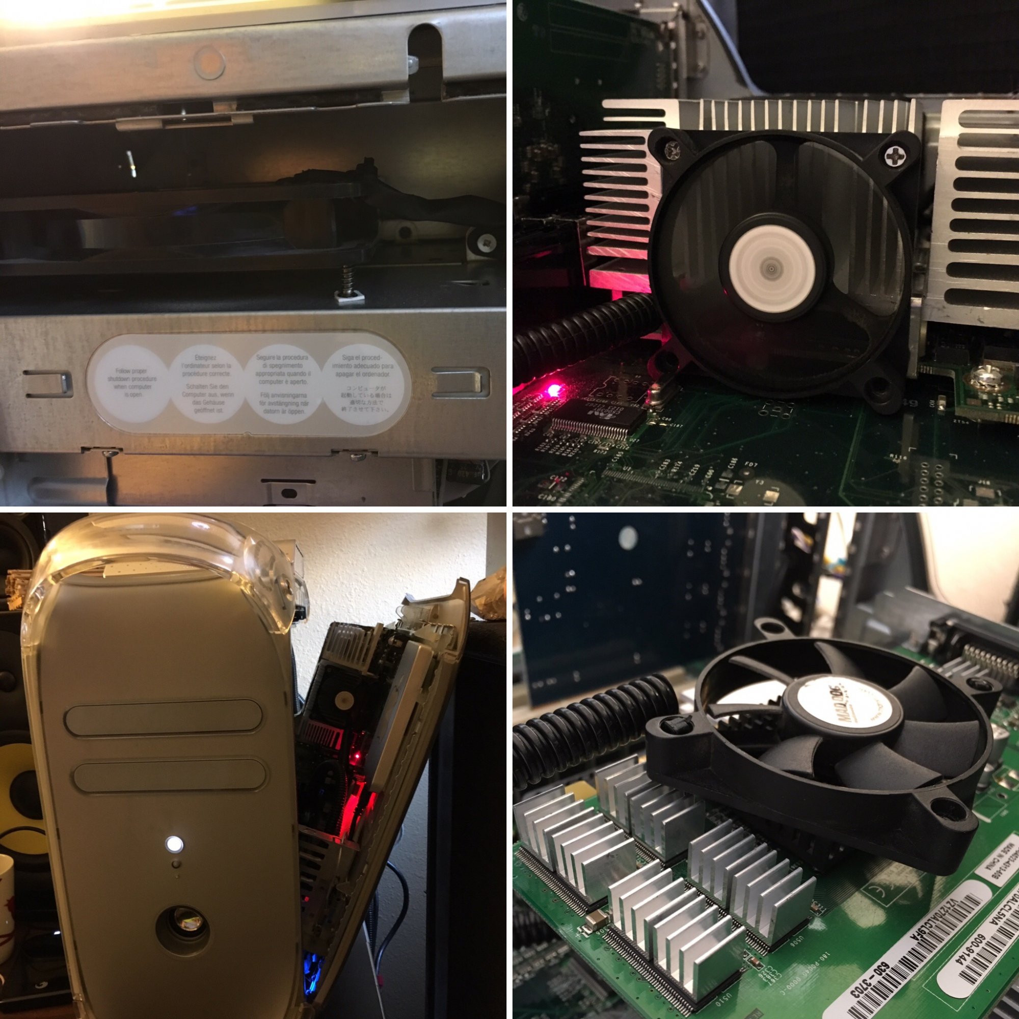

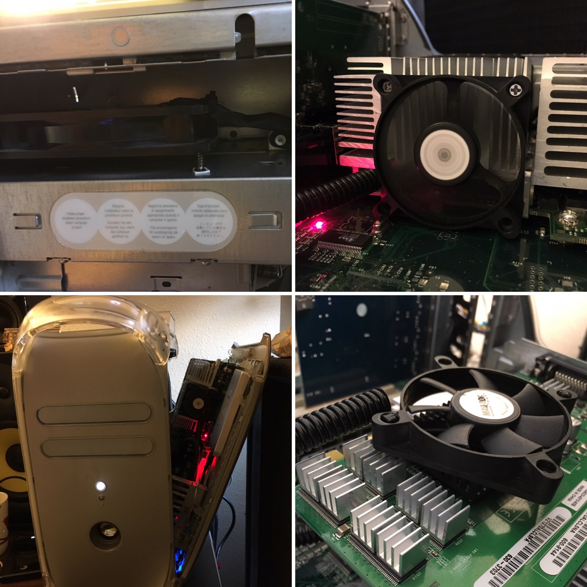

I used a small set of fans harvested from an old maddog hdd cooler to help move air around my cpus & gpu in my QS.
I’m not sold on the absolute necessity of them but it does help. I also believe that replacing the old 120mm fan with a high quality new fan like a noctua really helps with cage vibration.

Compared to the MDD the Quicksilver seems pretty quiet, so I'm not yet convinced that I need to replace the stock fans with something quieter.
In any case, I've looked through the specs for the two QS fans on Japamacs (http://www.jcsenterprises.com/Japamacs_Page/Cooling_and_Fans.html), and am struggling to find Noctua fans that match the noise and output of the original ones, unless I am calculating something wrong. The ones that Japamacs recommend for the Quicksilver don't seem to be sold anymore.
I'm leaning towards keeping the machine without an optical drive or hard drives for now - just a single SSD - so that should help with airflow. But you are not the first to recommend additional fans, so an idea might be to add an additional quiet Noctua fan (without a sensor, as there are no sensors left, so it would be spinning at a constant RPM), and mount it where the optical drive would be. Though I also have a few small fans lying around scavenged from an Xserve, so I could try to make those work.

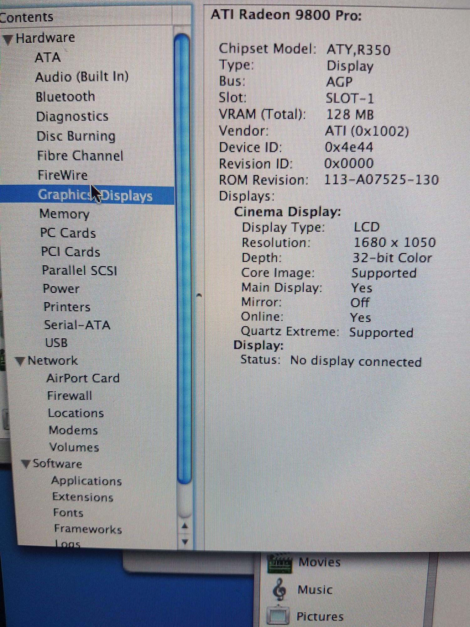

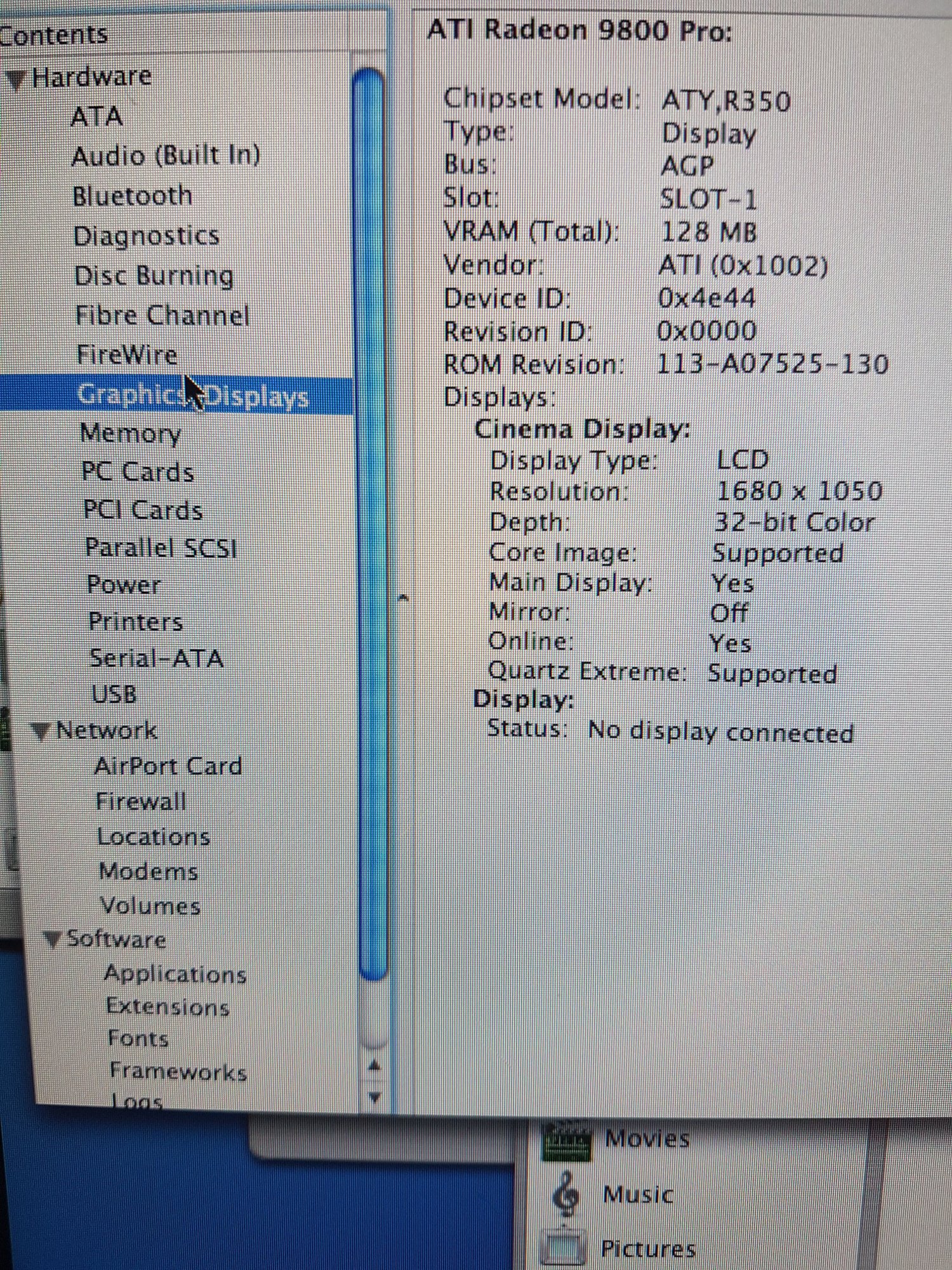

Success! ATI Radeon 9700 successful flashed, using ATI Flasher in Graphiccelerator under OSX Tiger (no need to safe boot) and controlling from my Mac Mini screen sharing. (I tried to use Jaguar but screen share didn't work). The card requires extra power and has a floppy connector, so I used a £1.50 floppy to molex adapter which worked like a charm. As expected I had to tape pins 3 and 11.
Extremely easy! I used the ROM for the Radeon 9700 (after verifying that my ROM chip was the full-size 128k) in the MacElite website. I presume it shows up as a Radeon 9800 Pro because the 9700 ROM is just a modified 9800Pro one.
Very pleased!
Very pleased!
Very pleased!
