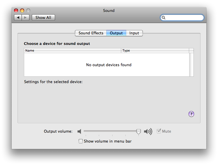

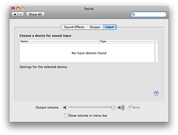

So, here's what's wrong:
1- Under sound in system preferences- output volume is muted and I can't un-click it
2-Also under sound in system preferences no devices are found under output and input
3-The sound symbol doesn't show in the top toolbar.
Also I googled this same problem and a lot of other people say a red laser is coming out of the head jack on the computer, I however don't have this problem.

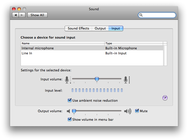

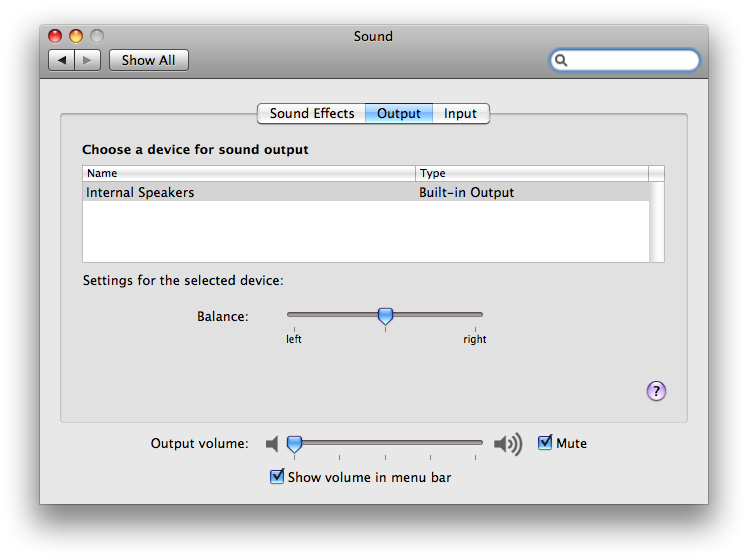

Don't really understand what you are talking about.
Possible for you to take a screen capture of your input/output sound settings?
cmd + shift + 4 + space
anyways, mine looks like that.
Yes sorry, here's what mine looks like.
