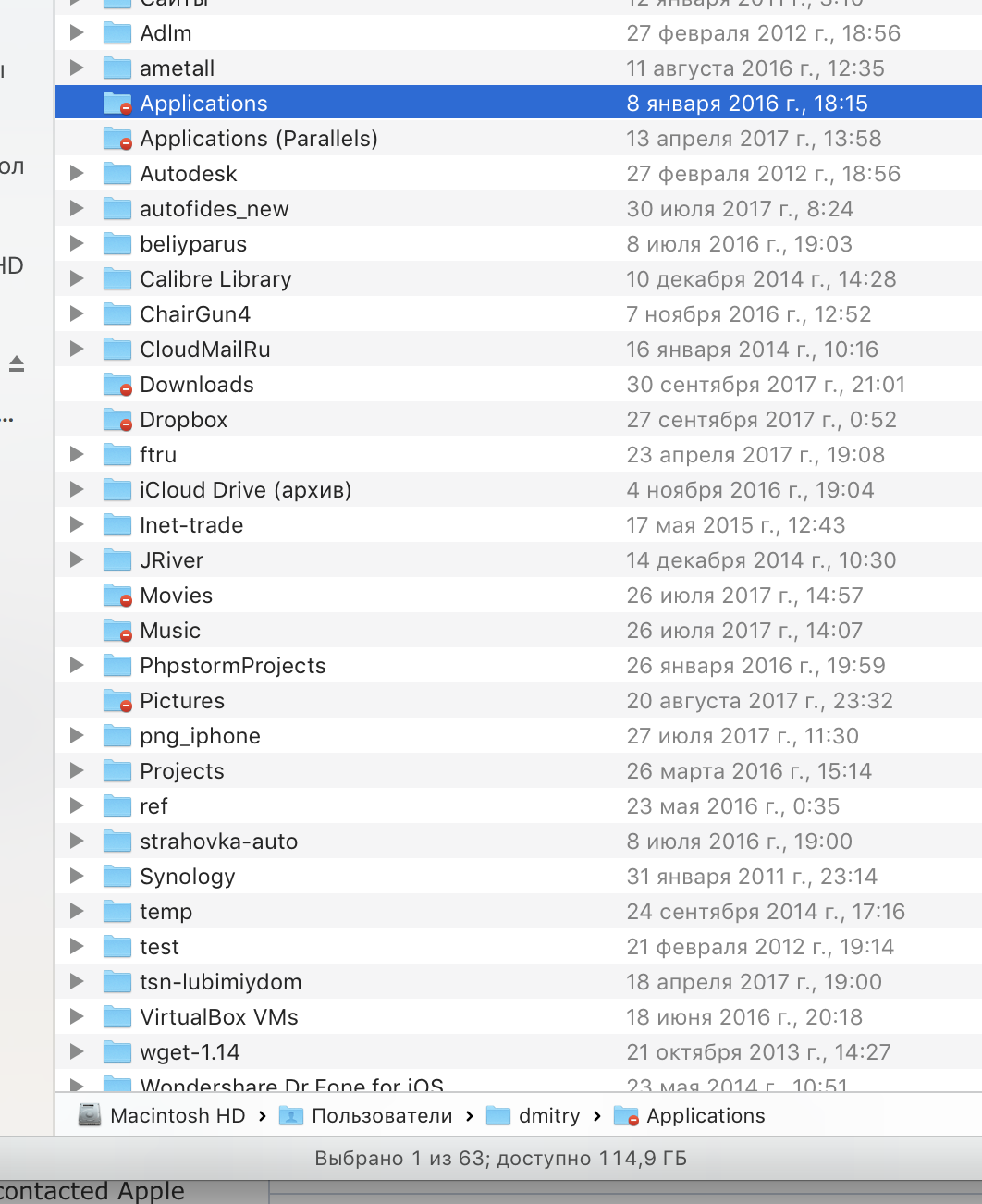

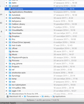

I had a 2015 model of MacBook Pro and did a backup. Now I wish to restore it to the new one. I set a user and then launched the Migration Assistant. I selected the user data, old profile, other files and leave unselected checkbox "system settings".
After that I have an old user folder, but can not enter inside (do not heave a permission and can not change it in the "Get Info").
Ok, I launched again the Migration Assistant and selected "system preferences", but still have no old profile in settings and can not get an access to the old user folders.
Fixed: Followed this guide https://support.apple.com/kb/PH25515?viewlocale=en_US&locale=en_US
