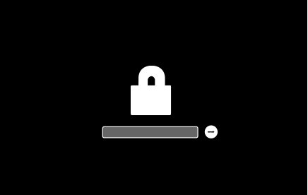

I attached a picture of the EFI padlock screen.

Unfortunately, booting with anything other than the internal SSD will not work if the Air has an efi password.
This is true and Apple will not help if you don't have a legit receipt proving that you're the legitimate owner of this laptop.
Very true. Hopefully, the OP is able to recover the password.
I hope so as well. Part of the risk of buying a "used" Mac laptop is if the previous owner placed an EFI password. Worse if they forgot their password.... it happens unfortunately. I have been lucky in that all my "used" Macs did not have an EFI password assigned to them.

No, unfortunately.
The password is in firmware, not on the SSD.
The only fix now is to take to an Apple service shop, and provide proof that you are the owner, such as an Apple receipt showing your name.
[doublepost=1564427196][/doublepost]Would replacing the SSD do the trick.
Replacing the ssd won't bypass the firmware password and allow you to reinstall the os.
The point of the firmware password is to prevent the air from booting from any drive other than the ssd inside the machine when the password was set.
I was trying to erased may hard drive and start from scratch as if I just bought it. Well I erased the Macintosh HD and now I get the folder with ? mark or padlock password screen. Now It does nothing while holding command + R at start up, or any other command for that matter. Please Help.
If you're the original buyer you can take your receipt to Apple and they can remove the firmware password. If you bought the computer used, your only option is to contact the previous owner and get them to give you the firmware password so you can enter it. Otherwise, you have a computer you can no longer use.
