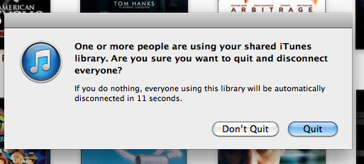

One more interesting thing I just discovered. Even with all the devices powered down iTunes still thinks they are connected. See attached pic.
Maybe the solution is just to shut down iTunes at the end of the night before I head to bed and then open it back up in the morning and let it start from scratch once again???
