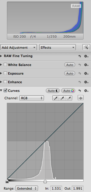

To help better illustrate my point, I believe this is the situation... as I've illustrated below. The Normal Histogram we see is misleading in that it implies data is clipped when it is not. I guess I'm wondering why we can't have a proper RAW histogram that actually shows when data is really being clipped? Is this technically impossible for some reason or are camera and software companies lazy, or am I the only one that sees a need for this? :D
You can access this "expanded histogram" albeit not directly in the histogram itself!
The default histogram is a representation of the RAW file in a 24-bit RGB color space, which means all the colors must fit within (255,255,255). Anything above that is clipped and is beyond the 24-bit color space and cannot be represented by that system. Since the final image is to be in 24-bit also, the histogram shows how the RAW file conforms to the 24-bit color space.
You can see the RAW histogram which you pointed out in the expanded curves plot, which overlays the histogram over the curve for a visual representation of the curve edits. This can be done in Aperture, not sure about other editing programs.
Interesting... I need to explore this... here's the elephant's RAW histogram in Aperture using the extended curve range...

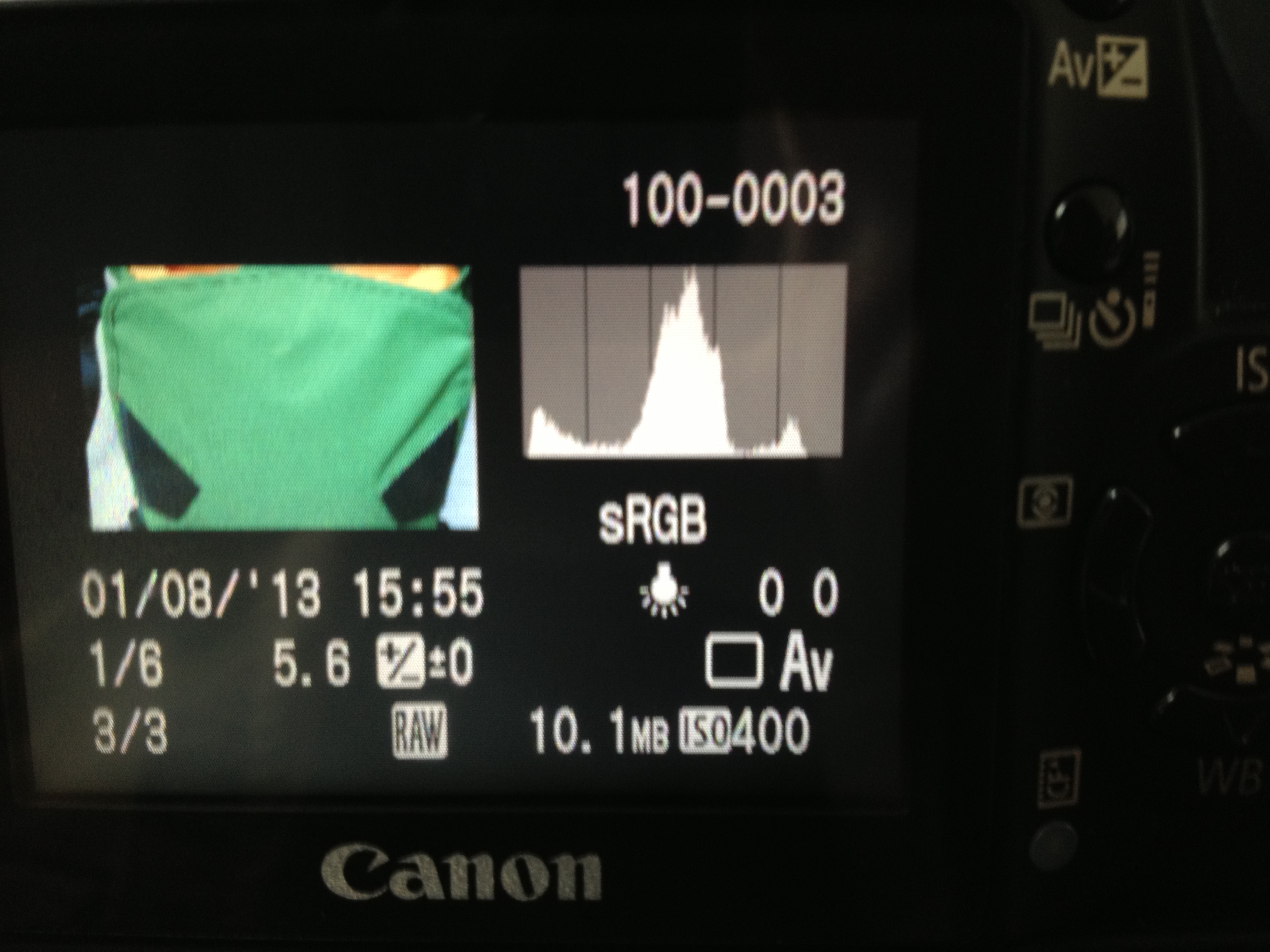

Isn't the answer to your question simply that DSLRs don't display accurate data in their histograms? Perhaps there is a technical reason they don't do so (though I question this given the ability of Leica to do it in a monochrome sensor). Or it's just camera makers are lazy with their features, assuming that no one will notice or care. We should all bitch so the camera makers include a feature that is actually useful, like histograms that actually reflect what the sensors are seeing :)

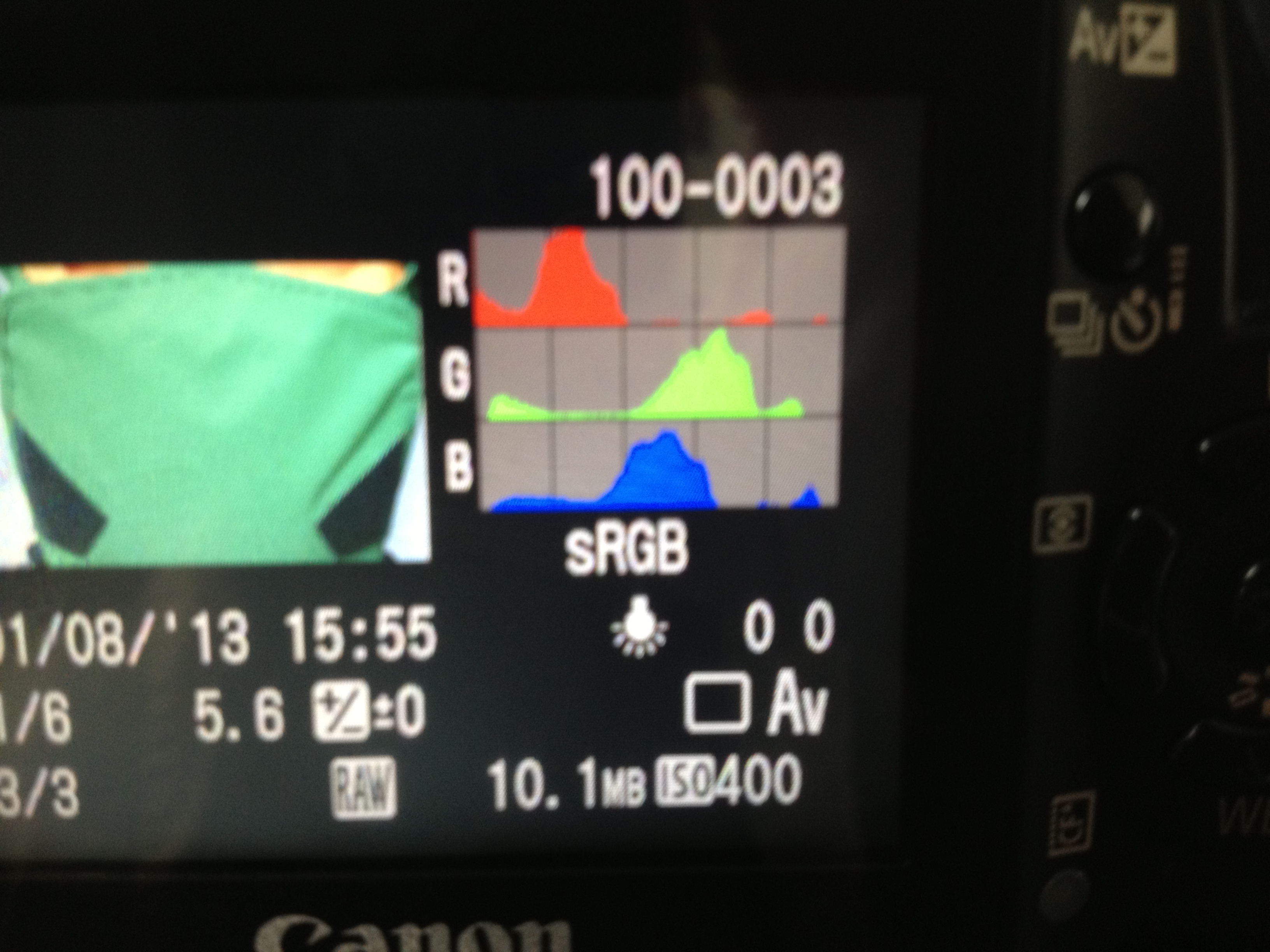

Forgive my ignorance here, but wouldn't it be possible to have the individual histograms representing each color channel actually display the RAW data available for that channel? Not talking about a combined histogram.
I got burned several years ago while shooting pink/red flowers in Hawaii on a Nikon body. The meter showed an adequate exposure. The histogram showed an adequate exposure (this was on a body that only displayed a white "overall" histogram--i.e. the green channel). The actual image was completely blown out with no details present. I learned my lesson and started viewing the individual color channel histograms once I got a body that could display that info.
The ability to view individual color channels on the histogram is a huge improvement. The fact that they are based on an in-camera JPG and not the actual RAW data is...strange.

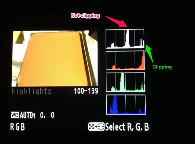

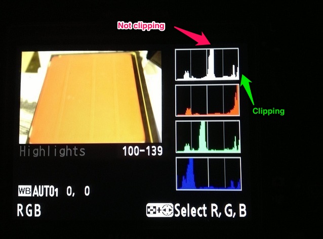

I stand somewhat corrected. The combined histogram on my D800 is "sort of" a combination of all the channels. However, it is seriously weighted against certain channels.
As an example, here is an image of the D800 display from an image of the red cover of my iPad.
Note that even though the combined white channel shows some highlight clipping ("blinkies" on upper left only), the red channel is completely blown out, far out of proportion to what the "combined" channel would suggest (if you look for "blinkies" when viewing the red channel, the entire cover is blown out). Since the subject is red, there is actually no usable detail here and the image is horribly over exposed. The meter was fooled and if you were basing exposure on the combined histogram you wouldn't have known this.

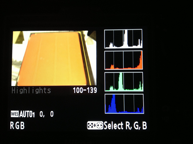

You got me questioning myself. Luckily I had my camera next to me for testing. The shape looks similar, but you can see that they are in fact different. Maybe it's just my camera, but if my old Canon XTi has it and your Nikon D800 doesn't then yikes! Somebody call Nikon quick!
See my corrected post above. I pulled out my D800 and shot a red subject. The camera metering seems to reflect the combined channel which is weighted heavily towards the green channel. In most shooting, this isn't an issue. When shooting red subjects, there is a very real chance for overexposure.

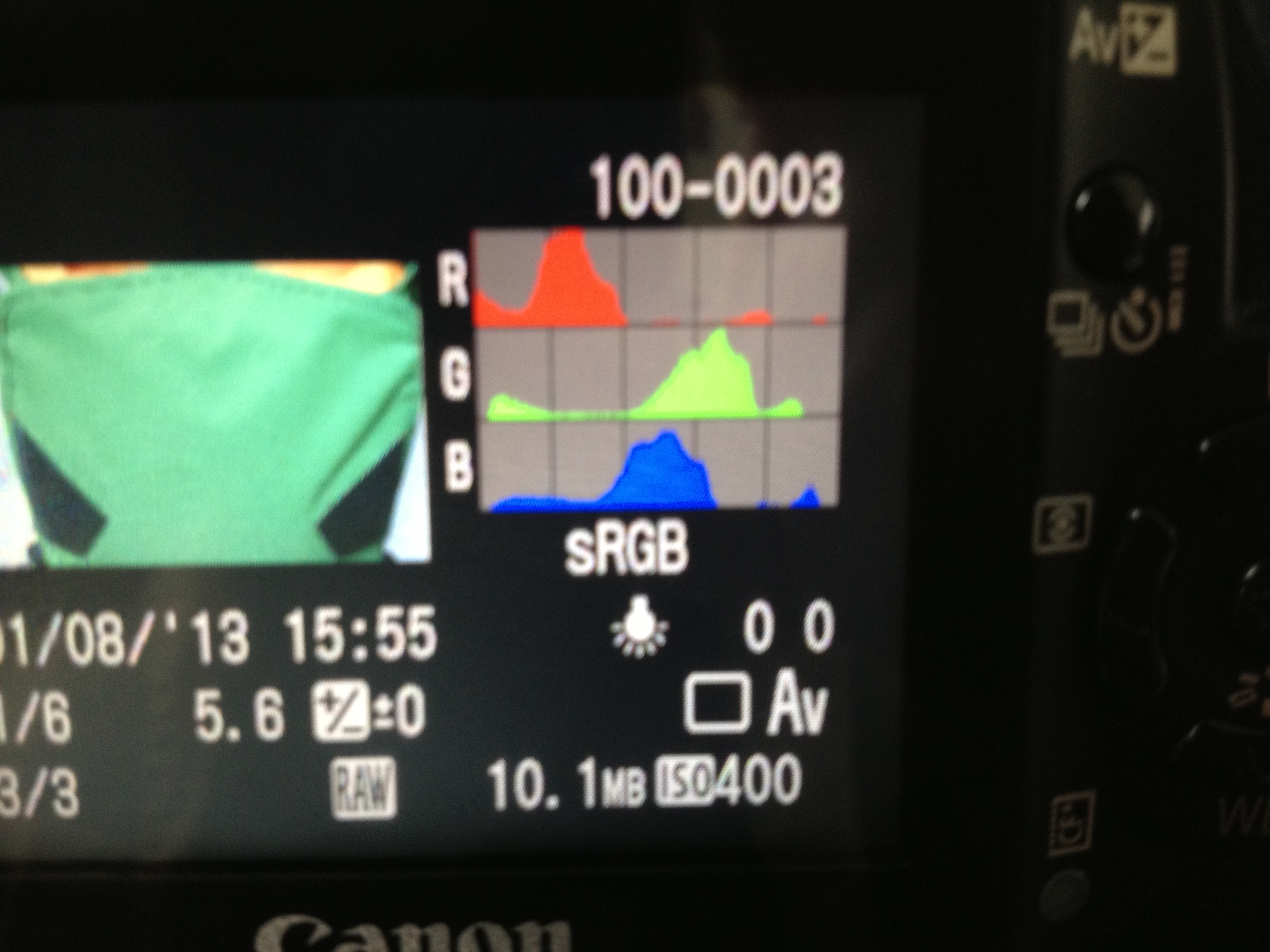

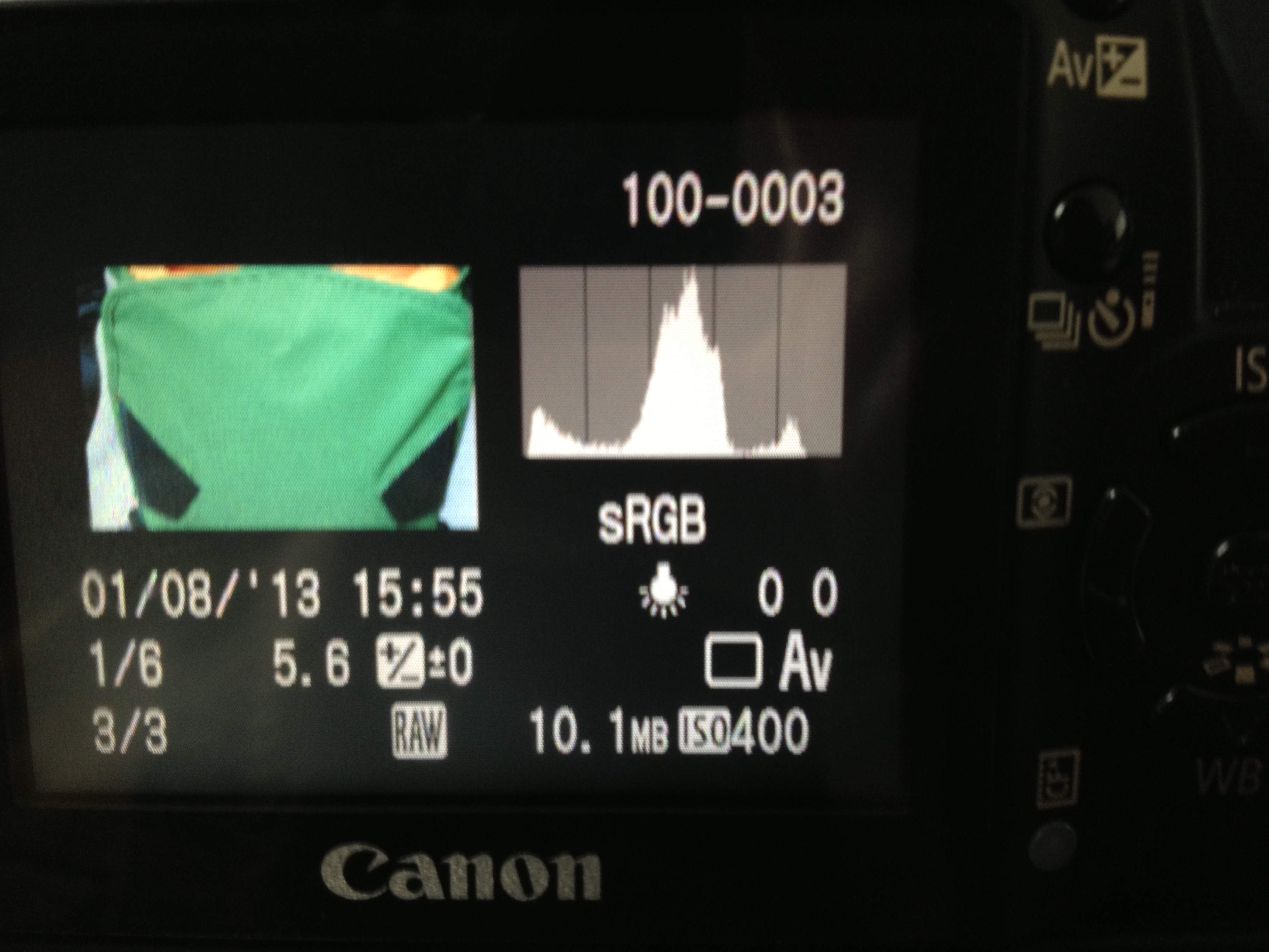

I can't figure out how to prove it but I'm pretty sure my Nikon D200 has a raw histogram because it can display four histograms, one for each channel and one for white. It does this even when I ask the camera not to produce a JPG file. When the camera says the pixel is clipped it really is clipped when I look later on the computer. It will also blink the blown red, green or blue pixels or I can have it blink the blown white ones. It appears to be working at the raw level.
I don't know about the newer or the lower end Nikon SLRs but mine does what you are asking for.

Which Nikon body? My Nikon D200 has this feature and it works just like what you are asking for.
I used to have a Nikon D50 and it only had the white histogram. I guess when you buy a camera this is one more thing to look for
Very interesting and illustrative example IMHO.
So to re-iterate, my point is that although the red channel appears completely blown out in this histogram, the fact is, it was probably not actually clipped by the sensor. Something we can't possibly know without looking at a histogram of the RAW data.

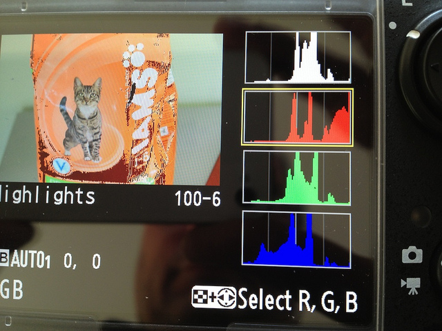

Okay, will attempt to address both issues that are running through this thread.
(1) issue raised in the OP--why are highlights appearing blown out on the histogram but actually have detail when viewing the RAW data of the image.
(2) the standard histogram isn't displaying accurate information regarding exposure, specifically relating to the red channel.
Note that the common channel reflects an adequate exposure with only a little bit blown out on the right. The red channel shows that quite a bit more of the image is actually blown out and since the subject is red (well, orange in this case), the red channel is actually over-exposed. For this color image it isn't a major problem, but if you were going to convert this to B&W and use the red channel for your source channel, you would notice the over-exposure. Note well that all of these comments are based on the histogram displayed by the camera (which is based on a JPG). It does *not* relate to the actual data captured by the sensor.

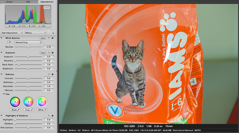

Here is the histogram displayed in Aperture based on the RAW data from the camera:
Note that the red channel isn't actually blown out and there is usable information there. Note further that there really isn't significant clipping at all. Had I captured this image as a JPG, then all of my above comments would be valid. Because I shot in RAW, none of them actually apply. You could use the red channel for a B&W conversion--there is usable detail there.
I will state again that the camera histogram is based on a JPG and *not* the RAW data. So the information displayed on the in-camera histogram does not reflect what the sensor actually captured. Also, the histogram is biased towards the green channel, which in some circumstances can cause problems when shooting red (or possibly even blue) subjects.
In this example, the camera actually obtained correct exposure even though the histograms might not have shown this. There are other cases in my experience where the camera actually missed exposure and clipped the reds even in the RAW data. Bottom line--you can't trust the histogram on the camera. This may also serve as an example of why it is better to shoot in RAW.
