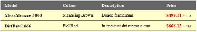

This is what it looks like:
This is what it needs to look like:
The question is where did the lines goes on my table; and why is the title of the table not aligned with the table?
I got the th to become bold,but can't figure out the rest.
You need to revise the HTML for tables, what you've posted is invalid. Tables start and end with the <table> tag, then you list each row with the <tr> tags and inside those rows you list the columns with <td> tags (or <th> for the heading row).
In your example you've got columns, inside a table, inside a row then columns inside a table with no closing <table> tag. Also your headers don't line up because you're not using the same number of columns in each row.
Here's some commented code for you to look over to achieve the desired outcome:

The comments, everything between and including the <!-- -->, can be removed. Perhaps try extending the table with more data rows and changing the styles until you're happy with how HTML tables work.

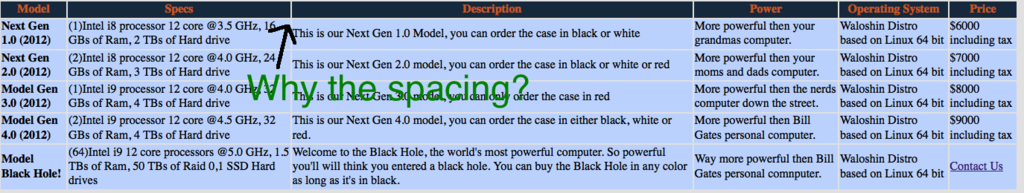

Why the spacing in the header of the table?
Figured it out: <table cellspacing="0">
