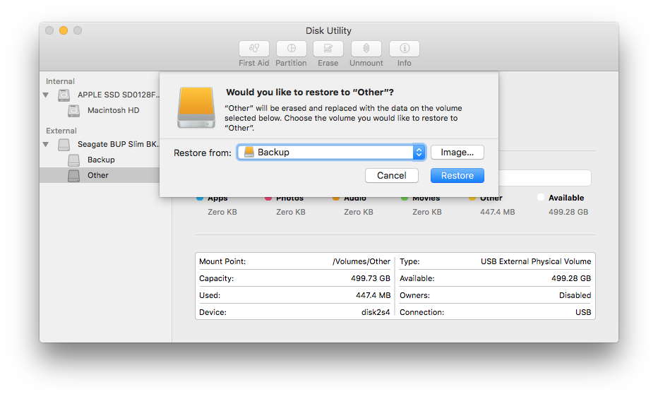

You can boot to the external then attach another external and format it.... then use Disk Utility to restore the broken internal partition to a partition on the second external drive. With the drive compromised, this may or may not work.
In my example I selected Other as the destination then selected Restore in the edit menu, then select Backup as the source. So this would in effect clone Backup to Other in my example.

[doublepost=1470206333][/doublepost]I would also aim to salvage your Home folder as that is where most programs store anything created by the user. It is very rare for a program to store your important works and documents anywhere other then the home folder.
I just got the following message after booting up using Command + R and trying to repair my troublesome HDD...
The more you try and repair the drive like this, the less likely you are to recover any data at all. Just boot to recovery, unlock the drive in Disk Util then use Disk Util to restore the internal drive to another external drive. That is your best hope at this point.
Reactions: grahamperrin

It does sound like either your drive died, or you have a bad drive cable.
I'm going to circle back around to my first post (#2 in the thread). If you can take the internal drive and put it in an external USB case, and all is well like you just described, then you have a bad internal drive cable. So you need to replace the cable then put your original internal drive back inside and all will be well.
https://www.ifixit.com Sells the cables.
