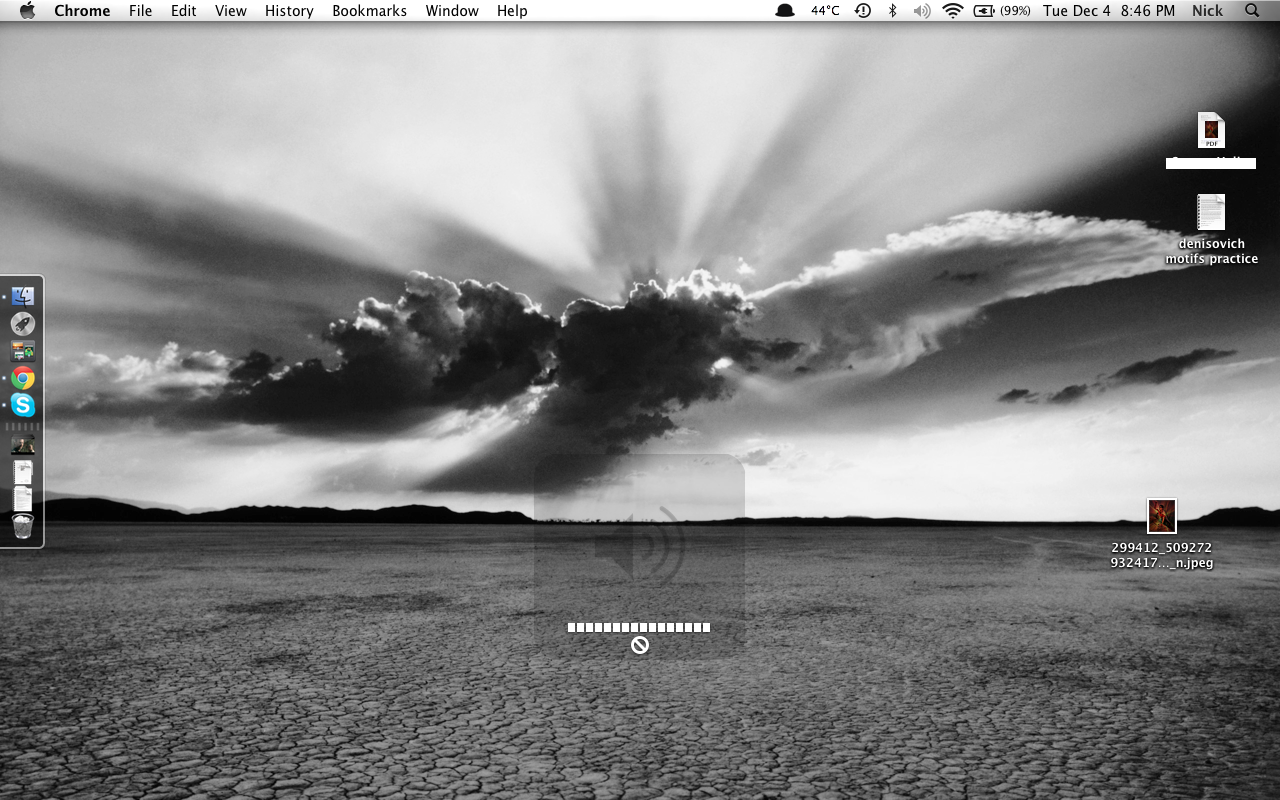

I'm not really sure if my sound is broken or if it needs repairing but it keeps going on and off.
Once in a while the sound will go off and when I click on the volume button, usually the volume symbol is white and the sound level bubbles will be too.
In my case, the volume symbol will be transparent (see-through) and the bubbles will not be filled at all (like its mute) and below the bubbles will be a circle and a slash across it.
6
(Picture of what I am talking about ^)
The only way for me to fix this reoccuring problem is to restart my computer which is VERY annoying and fustrating. And sometimes restarting may not work and I would have to restart it several times to get it to work again..until the problem comes up again....

Either you are plugged into an external monitor using HDMI (sound output is thus regulater by that monitor/TV). Or you have triggered the little prong in the headphone jack for optical cable sound. You would then be seeing a red light come out of the headphone jack.
If that's the case, plug in a pair of headphones and plug them back out a few times, you should be able to pry it back in place that way.

Yes, like so:
It can get stuck like that sometimes, from what I gathered from reading here, it seems to happen more often on the 13 inchers.
if the red light is on your computer is using the output optical audio (this is for hooking up to an audio receiver/tv, not for headphones or standard speaker connection). you can change this in preferences->sound->output then choose internal speakers or headphone port. I also see you have skype open, I'm not too familiar with it since I don't use it myself but check the preferences of that app to see if there is any sound output options set to optical or digital, and change them to 'default' or internal speakers.

So speaking in general, this problem is not because of my laptop but because something is triggering it? So no use going to an apple store to fix the problem and pay money right?
