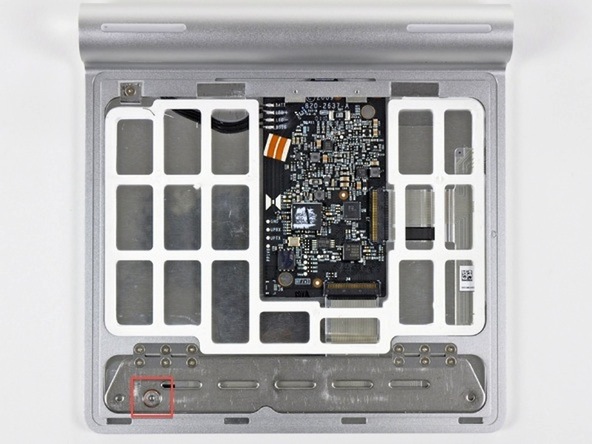

I was too lazy to bring it back to the store. I ripped the white plastic from the back. It's fastened with a couple of glue strips. When you take it off, it bares the aluminum frame. Within that frame, the white nubs as well as the electronics are bolted on. Very interesting to see. And incidentally, it also made the trackpad click again.
But I only advise that when you're blessed with insatiable curiosity. The easiest is to bring it back to the store :)
For the curious, here's a picture. Source: iFixit repair guide for Magic Trackpad 1.
