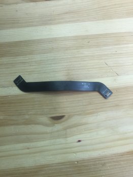

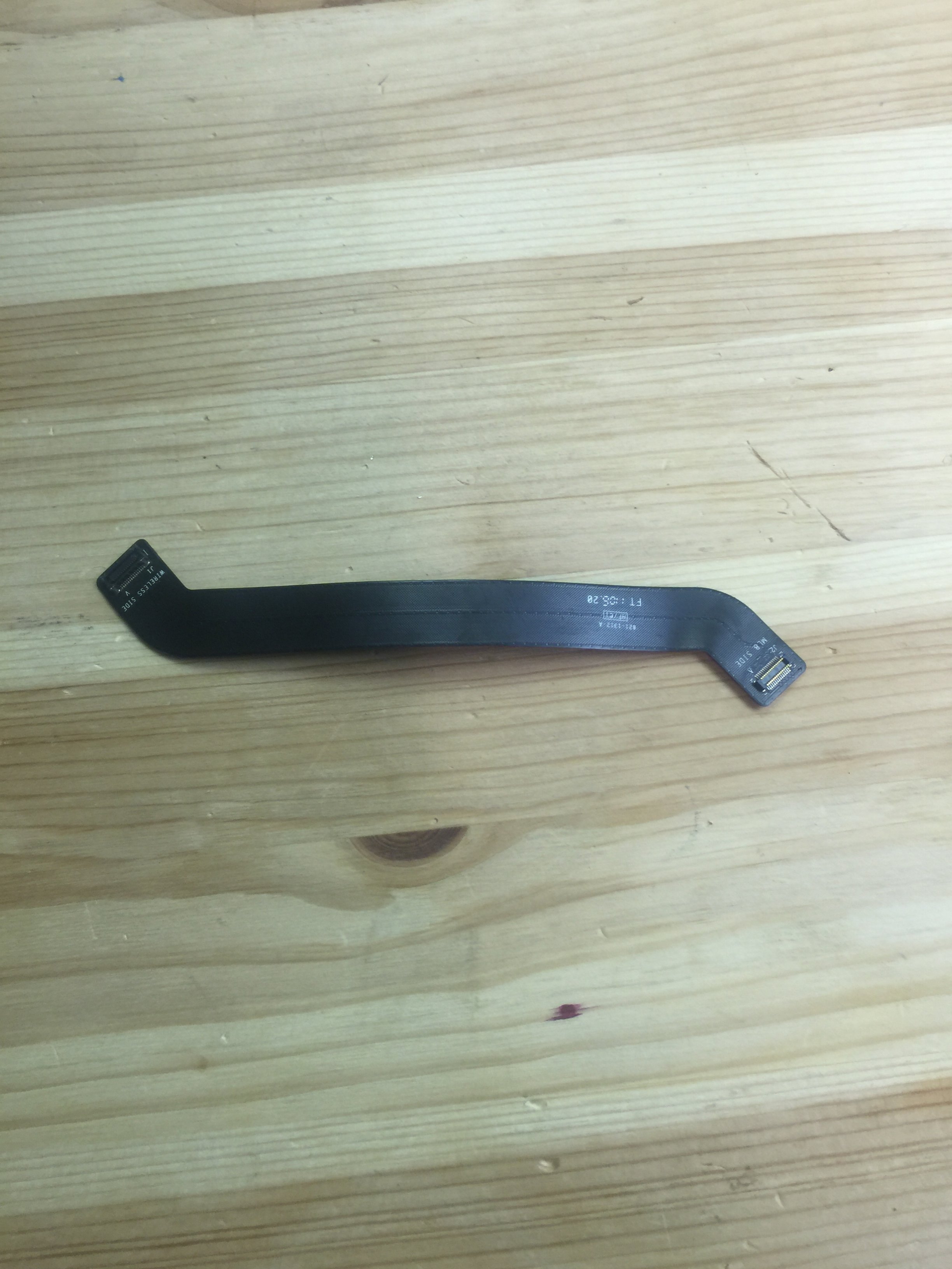

Nothing to do with your HD cable but there is a possible cable /cables you should check . If you take bottom cover off , your wifi card is on the backside of the optical drive , you will see little connections for all the antennas and then a cable that runs from it too your logic board .
Often the backside of that cable is loose press down on it and also check the connection of the board , unplug the battery before doing any of this then recheck your wifi

Is the AirPort cable the wifi cable? https://www.ifixit.com/Guide/MacBoo...2011+AirPort-Bluetooth+Cable+Replacement/5887
Thx, in other words, it has nothing to do with the sata cable. Can something be wrong with the connection to the logic board? Is there a visible connection that I could check?
Here is a iFixit instructions on how to replace the Airport/Bluetooth board. Step 7 to shows the antenna connectors to the Airport card. Make sure you have the correct tools.
