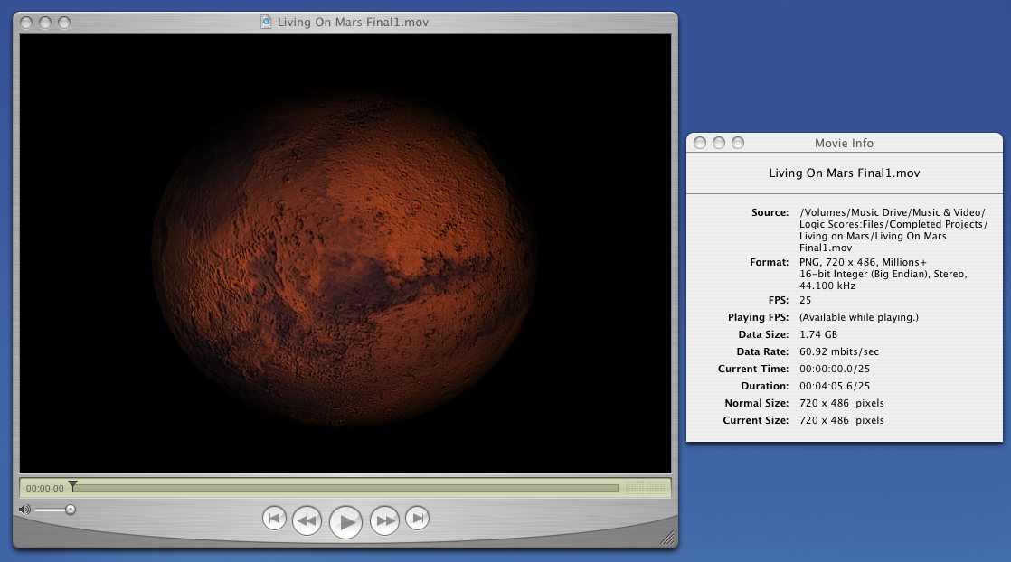

The "Movie info" of the original when opened in Quickime are:
Format : PNG, 720 x 486
Millions+
16-bit integer (Big Endian)
Stereo etc...
FPS : 25 (need to keep it to PAL)
1.74 Gig

I have taken a screenshot of the "about movie" sceen in Quicktime, hoping that this will be all the information you need - if there is anything more specific, please let me know.

Where did the movie file come from? It could be a couple things.
1. 720*480/6 (it really is a non-issuse) is the correct size of NTSC, but you are PAL. DV PAL is 720*576.
2. If the planet mov was made in a program like After Effects and they used square pixels then you would see a distortion in iMovie 'cause iMovie (like all digital video for use on TV) uses unsquare pixels.
Also, DV audio should be 48k, not 44.1 (like it is on the planet mov).
So go back and tell the guy that gave you the movie that you need 720*576, unsquare pixels, and 48k audio.
