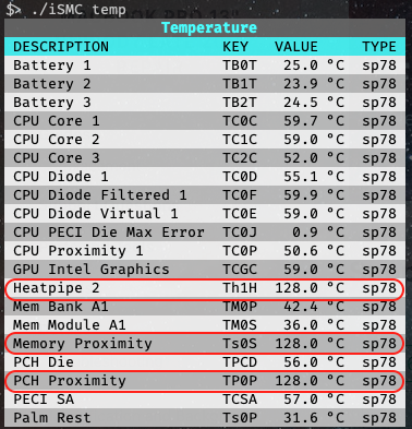

- Not the CPU temp sensors. Th1H, Ts0S, TP0P

Right there's three sensors there giving bad data.
