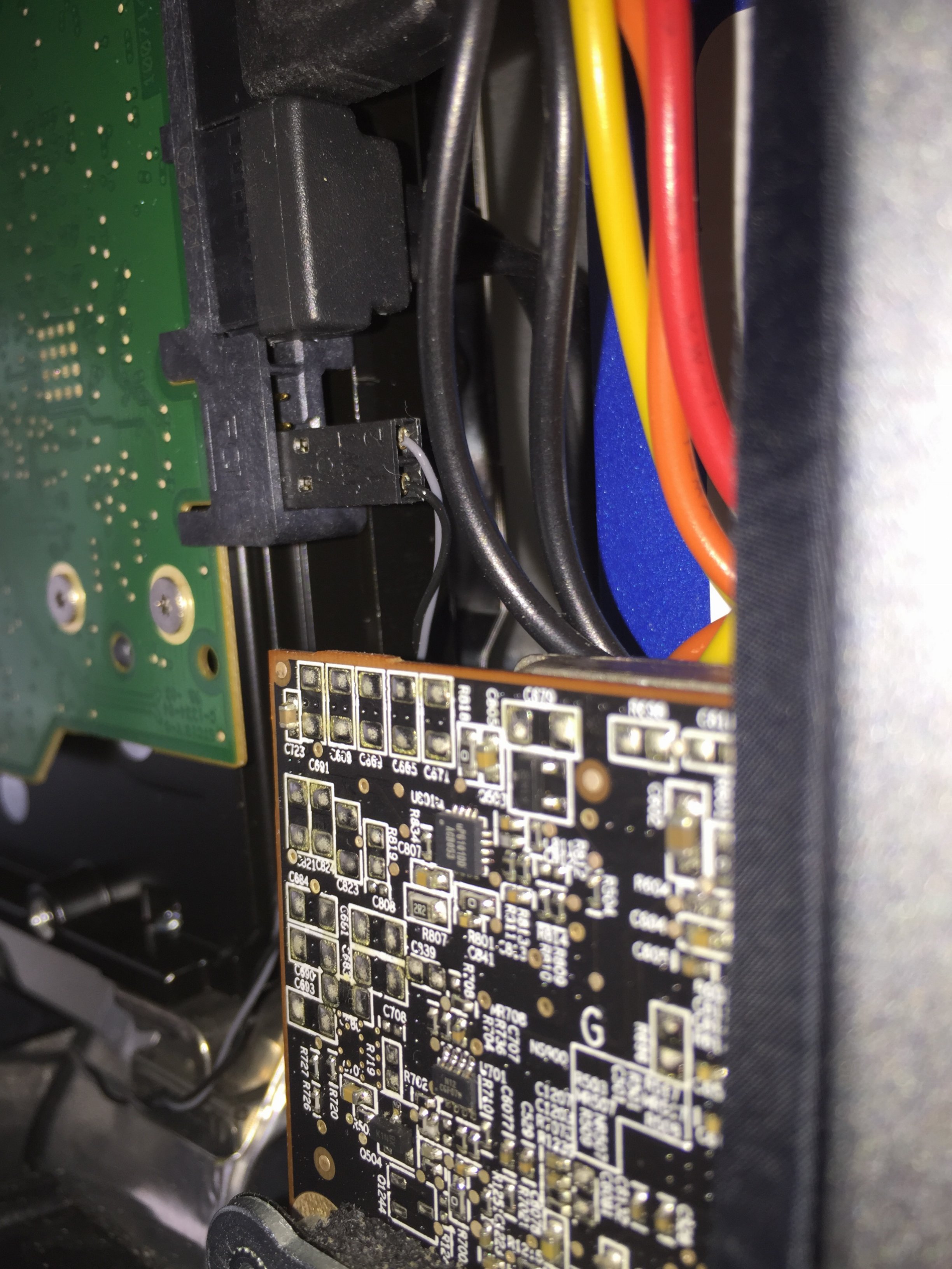

Hello.
I have a iMac Mid2010 27".
And I upgrade my internal Hd 1tb WD with the new Seagate 4tb Hibrid HDssd.
You can see here: http://www.amazon.com/Seagate-Gaming-3-5-Inch-Internal-ST4000DX001/dp/B00FQH7MQ2
I buy in Barcelona after some isues with other HD.... Fans work a lot etc...
This HDSSD in compatible with apple and work perfectly... I don't need any extra software to control the Fan.
You only need to connect the thermal sensor to the 2 pins more far away the power conector.
I have a another SSD install on my iMac and I created a Fusion Drive with the 2 Hdd.
