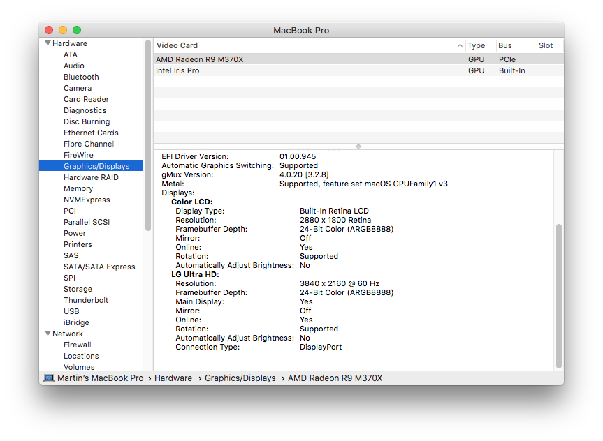

If you want 4K@60 Hz I would highly recommend getting either a USB-C/TB3 to DisplayPort adapter, a Thunderbolt 3 docking station, or a USB-C to DisplayPort cable. Either one of these should work. I've been using this display with a 2016 13" MacBook Pro and a CalDigit TS3 Lite TB3 dock for eight months now, and it's connected to the docking station via DisplayPort cable.
Double check the monitor specs as well. I have both Dell and Acer 4K displays. Both of them provided DisplayPort and HDMI cables in the box. Yet neither of them actually support 4K @ 60Hz over HDMI, that’s limited to DisplayPort only
According to LG, the 27UD68 supports HDMI 2.0: http://www.lg.com/us/monitors/lg-27UD68-W-4k-uhd-led-monitor
I've never tried using the included HDMI cable with an HDMI 2.0 device due to lack thereof it so I can't say whether or not it works and if so whether it works on both HDMI ports on only one of them. What I can say for sure is that it works with the included DisplayPort cable with the 13" 2016 MBP using the CalDigit TS3 Lite Thunderbolt 3 docking station as well as on the 15" 2015 MBP using an mDP to DP cable:
