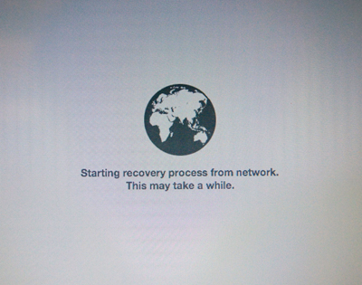

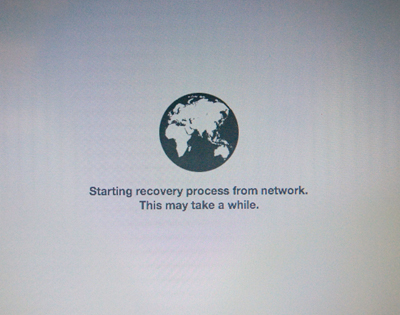

Its sounds like you are not erasing the drive before you try to reinstall.
After you command-option-r boot are you seeing this globe?
After the globe you should see the recovery screen. From there start Disk Utility and in the erase tab select the drive brand name at the very top of the left column. Then select Mac OS Extended (Journaled) in the drop down and apply that format. Then quit Disk Util and click reinstall at the top. You should not be prompted for an AppleID at all to do this.
